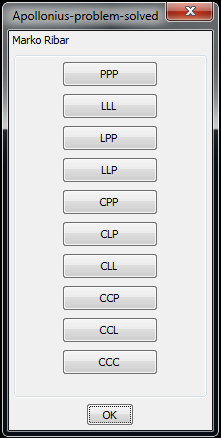

hanhphuc Posted April 17, 2020 Share Posted April 17, 2020 On 4/16/2020 at 6:52 AM, BIGAL said: A better way if you just want a certain number of commands to always be displayed then why not make a custom toolbar ! I took CIV3D pulled choices out of 3 menus and made 1 new that I run in my Drafting workspace saving having to change workspaces. I am happy to start you off its simple to do just start CUI and notepad you copy the details from the cui into notepad making your menu. I know you can do it all in the cui but I find it easier having a custom mnu that's easy to edit. This is a custom toolbar that I made, you can see the commands in it. You just use menuload to add it. ***MENUGROUP=ALANSTOOLBAR ***TOOLBARS **ALANSTOOLS $M=$(if,$(eq,$(substr,$(getvar,cmdnames),1,4),GRIP) etc.. few good marco for reference, this old fashion customize still useful if you have multiple 'commands' in 1 routine, my $0.02 the best way is customize toolbar, or alternatively perhaps using dcl eg: like @marko_ribar 's routine, you don't need to memorize too many 'commands' Quote Link to comment Share on other sites More sharing options...
BIGAL Posted April 17, 2020 Share Posted April 17, 2020 hanhphuc I agree like the look of Marco's dcl similar to Multi radio buttons with nicer buttons. Its a library routine so limited lisp knowledge required to make it work. Quote Link to comment Share on other sites More sharing options...
