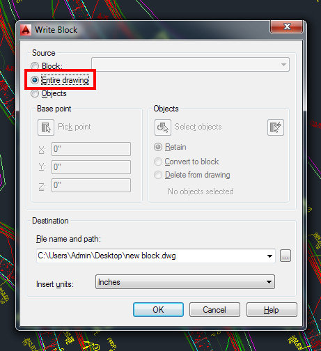

Cad64 Posted April 8, 2020 Share Posted April 8, 2020 When I run into bloated files, I use WBLOCK to save the entire drawing out to a new file. This strips out all the database junk that's inflating the file size. Make sure you're in model space with your UCS set to World, then run WBLOCK and select the "Entire Drawing" option. Quote Link to comment Share on other sites More sharing options...
Phil @ Peak CAD Posted April 8, 2020 Author Share Posted April 8, 2020 I'm afraid that didnt work Quote Link to comment Share on other sites More sharing options...
Cad64 Posted April 8, 2020 Share Posted April 8, 2020 23 minutes ago, Phil @ Peak CAD said: I'm afraid that didnt work If WBLOCK didn't bring down the file size, that means your drawing file is already clean and there are no issues there. So that means there's something about your model that's causing the file size increase, but without having your model in front of me to check, it's difficult to say what might be causing the increase. But, you did say the model is complex, so maybe 37mb is the correct file size for what you're working on? I've worked on 3D projects in the past where the file size got up close to 400mb, so 37mb really isn't that much unless it's causing Autocad to freeze up or crash. Can you post some screenshots so we can see what you're working on? Quote Link to comment Share on other sites More sharing options...

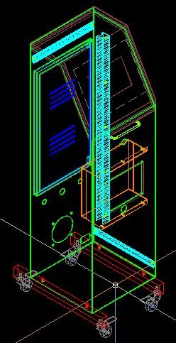

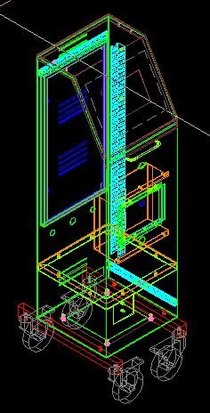

Phil @ Peak CAD Posted April 8, 2020 Author Share Posted April 8, 2020 Thanks guys Previous version at 8mb Not a great deal of edits (really) but you can see I've sealed some holes up, cut more, built new casters, and a more complex door arrangement at the front. About this time it started lagging when selecting, copying, changing view etc, and after I'd saved to close down and restart, the new file size was there. BREP, PURGE etc, added 5mb to it! Quote Link to comment Share on other sites More sharing options...
Cad64 Posted April 8, 2020 Share Posted April 8, 2020 Yeah, I'm with SLW210 on this. You've got a lot of detail in that model, so I would look at simplifying wherever possible. A good place to start would be to utilize blocks for things like the caster assembly. Make it a block and then copy it to the other locations. Creating blocks for things that repeat on the model, like nuts and bolts, should help cut down the file size. Also, be sure to put everything on separate layers so you can freeze things while you're working. There's no need to have everything visible all the time. Quote Link to comment Share on other sites More sharing options...

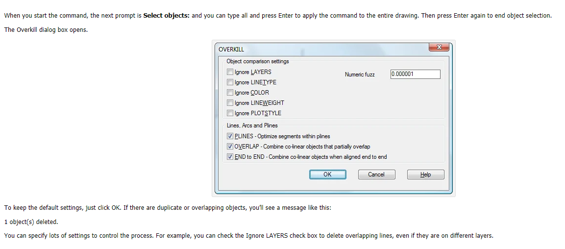

Chris.E_AllaboutCad.com Posted May 24, 2020 Share Posted May 24, 2020 Hi Phil, Have you tried OVERKILL command. That way you can do more than purge otherwise, what I can recommend is to check if you have deleted hidden items as well. How about saving it in wire frame instead of a realistic or conceptual mode? Source: https://allaboutcad.com/remove-duplicate-and-overlapping-objects/ Hope this helps. Feel free to message if you have questions Cheers, Chris Quote Link to comment Share on other sites More sharing options...

Phil @ Peak CAD Posted May 25, 2020 Author Share Posted May 25, 2020 19 hours ago, Chris.E_AllaboutCad.com said: Hi Phil, Have you tried OVERKILL command. That way you can do more than purge otherwise, what I can recommend is to check if you have deleted hidden items as well. How about saving it in wire frame instead of a realistic or conceptual mode? Source: https://allaboutcad.com/remove-duplicate-and-overlapping-objects/ Hope this helps. Feel free to message if you have questions Cheers, Chris Hi Chris Just tried -OVERKILL. Didnt change the overall file size unfortunately. I normally work in 2d wireframe unless I need to check something's looks. I do use HIDE, FREEZE and ISOLATE a lot, and have checked that. Client has now decided all he wanted was a concept drawing so its on hold now. Nothing wasted, as I have learned new things, which is always good. Cheers for your help everyone Quote Link to comment Share on other sites More sharing options...
