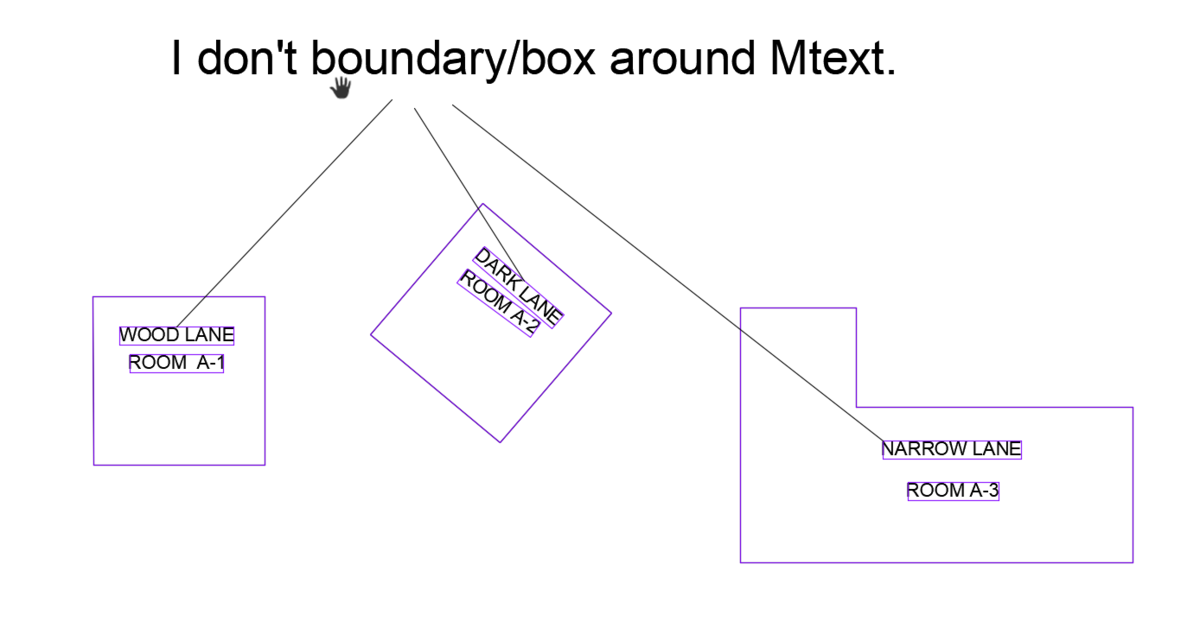

@Jonathan Handojo first of all ,I would like to appreciate your helping nature with everyone on the forum and you seems to be very down to earth 😇
I would like to mention that I don't want to create boundary/box around mtext ,that is the main issue in the above lisp.So let me give you more detail regarding my case.
Here we go-
I want to draw internal boundary across the rooms on the floorplan layout.The room layout may be made up of many elements such as lines,polylines,arc and even blocks (for doors,windows) in actual cases. and not simple closed polyline. So the above lisp is based on BPOLY command and Island detection, since in my case every room has text or mtext , it uses the insertion point of text/mtext and should draw the internal boundary across room (but in case of mtext it also draws boundary around text object which I don't want) . My intention behind using the text/mtext insertion point is that boundaries can be drawn for multiple rooms simultaneously.
I want output something like below Image (see it should not create boundary around text/mtext )
I know this BPOLY approach is not so perfect and have some issues like if there is gap somewhere in the room layout,  it gives error "VALID BOUNDARY NOT FOUND" but it didn't highlight or specify exactly which gap is resulting in this error.But somehow I have to work with it.
You are welcome to suggest some another approach/ideas or improvement in the current approach.
Here I am attaching a sample plan (dwg) and the rooms around which boundaries are required to be created (similar to above image) are named as "Room-A1,Room-A2 and so on"
Please have a look and give your valuable feedback!
sample plan.dwg

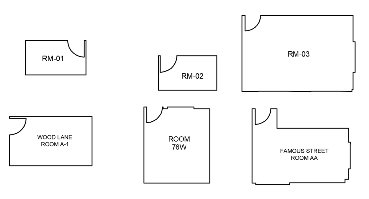

@dlanorh you seems to be quite experienced in the lisp. I request you to go through this and give your insight.Thanks
I am attaching the plan saved in 2010 autocad format for you.
sample plan_v2010.dwg

What are you trying to accomplish?

@dlanorh Please go through this post of mine.I have mentioned the details regarding what I am trying to achieve.
Thanks
The problem seems to be your door block, The architrave doesnt meet the wall polyline and is not seen as closing the gap. How have you constructed the polyline on layer floor? It's gone midnight here so I'm off to bed.:sleeping:
I would have thought the room size is wrong it should be calculated without the door arc This is a big amount if talking flooring material I have not seen carpet missing at the doorway.
Looking at the drawing  need a line drawn across the doorway on a no plot layer, then turn the layer doors off.
