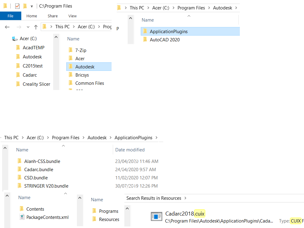

BIGAL Posted May 4, 2020 Share Posted May 4, 2020 My toolbars are custom.mnu files so a individual cuix is made. The cuix holds the bitmap images. Re install I have just started playing with .BUNDLE and its super easy code, menus etc and all loads on start up. You just need a sample xml to start with then edit it USE notepad++. You just match the application directories and make a zip then unzip into ApplicationPlugins. You can update files send to a user get them to save in correct directory and changes are reflected. I have been running a protected version of my software so my bundle to the end user is up to date and I know it works. 1 Quote Link to comment Share on other sites More sharing options...
