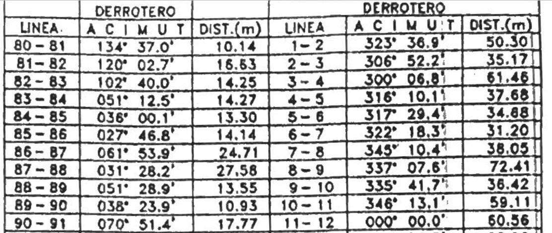

I think I offered to help this friend too soon and overestimated my CAD skills. I know this is doable in CAD but I can't figure how to do it.
I need to draw this land line in CAD from the table of points surveyed, which consists of an angle and a distance.
I've read 3 threads that discuss this but they all use a system of units that requires the direction and distance but my survey table only gives me angle and distances:
Point 1 to 2: -->  323° 36.9" @ 50.3 Meters
Point 2 to 3: --> 306° 52.2" @ 35.17 Meters
I've come across multiple threads with LISP but I don't know much about the subject to understand whether I need to give the direction of the line (N, E, S, W). It seems like it is required? But in my case all I have is an angle.
Could someone point me in the right direction? And I promise I will never again offer CAD help to my friends.

I would say that all which is needed is the angle and distance entered as "x.xM<yyy.y".
The N, E, S, W designations are just surveyor nomenclature for the 4 quadrants of a circle (360 degrees).

Great, because that is all that has been provided to me - I should be able figure out the orientation (N, E, S, W) from any given angle but so does the computer!

Your table consists of azimuths and distances. An azimuth is the clockwise angle from North, so the angle itself is in the range 0 to 360, and always tells you the absolute direction of a line. It is also known as a whole circle bearing. N, S, E and W have no use at all.
3 hours ago, Koko_NYC said:
 ....I've read 3 threads that discuss this but they all use a system of units that requires the direction and distance but my survey table only gives me angle and distances:
If you had a digital table of readings, then Lisp could give a fast solution, but as you are going to have to type in the data, you might as well do it by hand, using existing commands.
You have misread the angle data - it reads degrees and minutes (the minutes have a decimal).
So, to get you started, set up your angle system, to give you clockwise angles and a base angle at North. System variables ANGDIR to be 1 and ANGBASE to be 90.
Then you get started. Then start the line command. The first point is wherever you pick on the screen, and then type @50.30<323d36.9' ENTER, and you are off!!

Very clear! Thank you! It makes so much more sense now. I suspected I was in the right track but needed this confirmation.

@BIGAL - I have only a hazy fundamental knowledge of lisp, but does your lisp cope with Minutes with a decimal, and no Seconds?
What you have posted would work with most normal usage, but the OP only has (it appears) a printed list on the drawing, and the azimuth is quoted as DDD° MM.M'
You are correct, my table follows this format: DDD° MM.M'
Does the LISP work?
I have not tried it, because, in this instance, I would type out all the data by hand.
If you are familiar with lisp, have a go yourself. If lisp is a mystery to you, perhaps now is not the best time to experiment!!
Yes as the mins are / 60.0 so if decimal still works. try 45 30.5 which becomes 45d30'30" or 45.50833333
