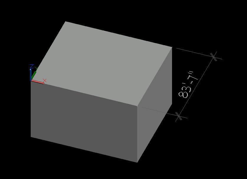

Cad64 Posted April 7, 2020 Posted April 7, 2020 On 4/7/2020 at 3:05 PM, Berzerker said: But I told it to dimension from the endpoint of the corner to the top of the extruded object. Expand Autocad places dimensions in the current X,Y plane. If you want to place dimensions on a 3D object, you have to move your UCS and set your X,Y plane on the surface of the part you want to dimension. In the image below, you can see that I set my UCS on the top face of the block in order to place my dimension. Quote
