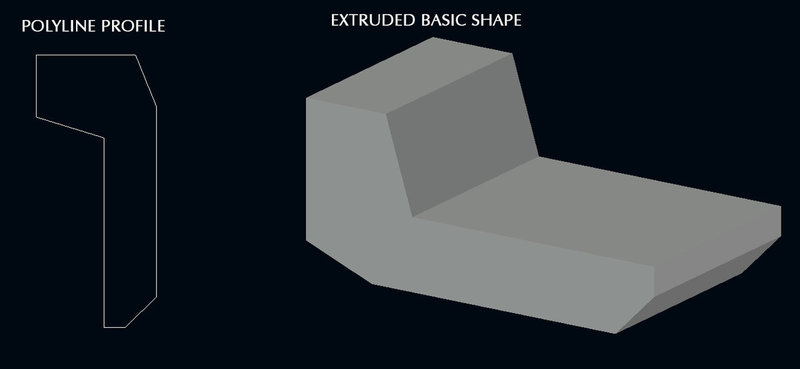

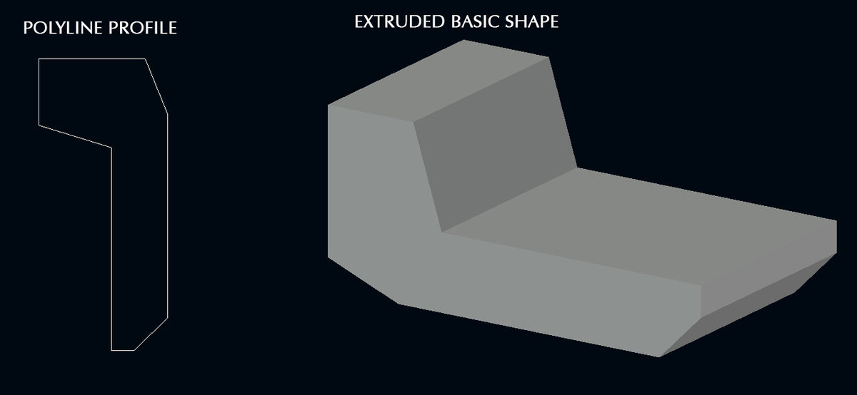

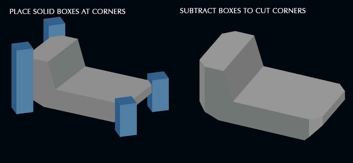

Cad64 Posted April 7, 2020 Posted April 7, 2020 Ok, here's my tutorial, part 1 1. Draw a polyline profile of your part 2. Extrude out your basic shape 3. Create boxes and move and rotate them into position at the corners 4. Subtract the boxes from the model to cut the corners Quote

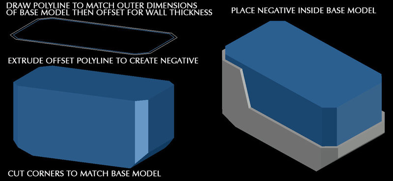

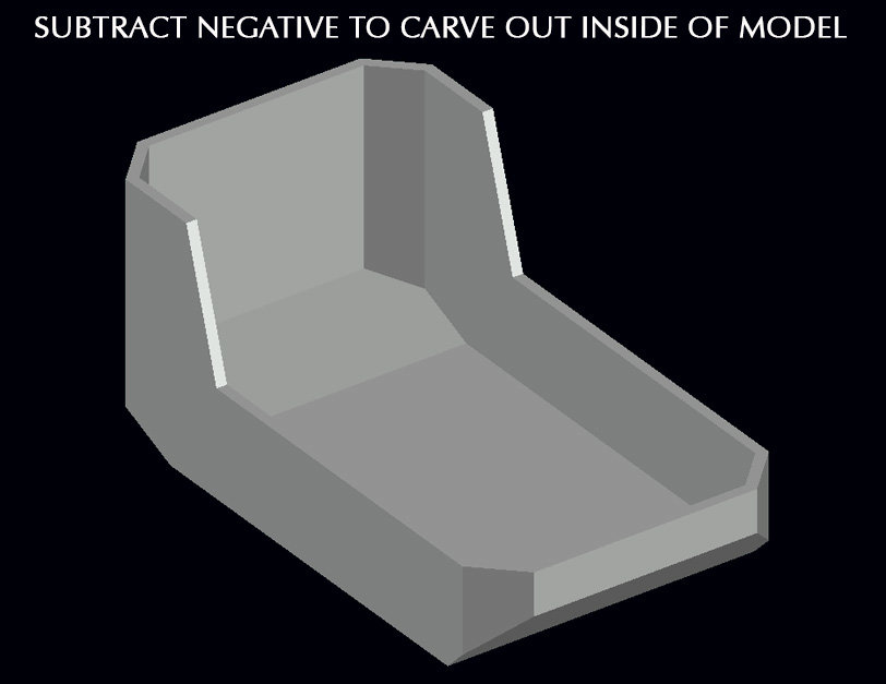

Cad64 Posted April 7, 2020 Posted April 7, 2020 Tutorial part 2. This part is a little more difficult and this is where a program like Fusion 360 really makes things easier. 5. Draw a polyline outline, the same dimensions as the outside of your model. 6. Offset the polyline the amount of your wall thickness. I used .125 for this tutorial. 7. Extrude the offset polyline to create a negative for cutting out the inside of the model. 8. Use boxes again to cut the bottom corners of the negative to match the angles on the bottom of the base model. 9. Place the negative inside your base model and then subtract it to carve out the inside of the model. Quote

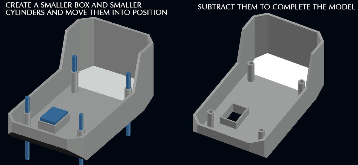

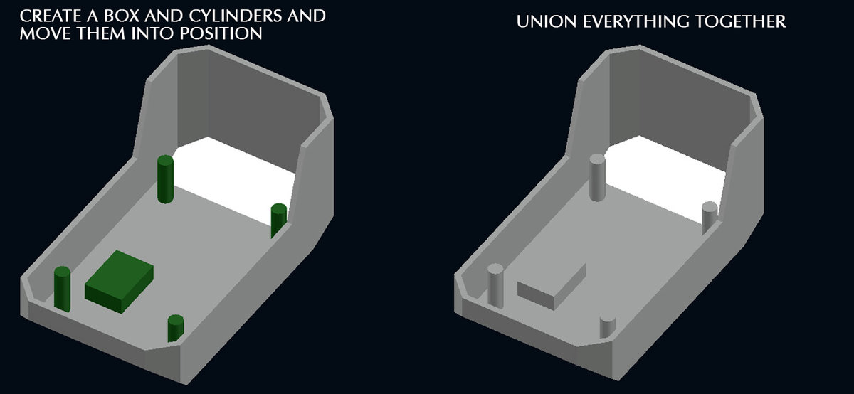

Cad64 Posted April 7, 2020 Posted April 7, 2020 Tutorial part 3. 10. Create a box and cylinders and move them into position. 11. Union everything together. 12. Create a smaller box and cylinders and move them into position. 13. Subtract them and you're done. Quote
