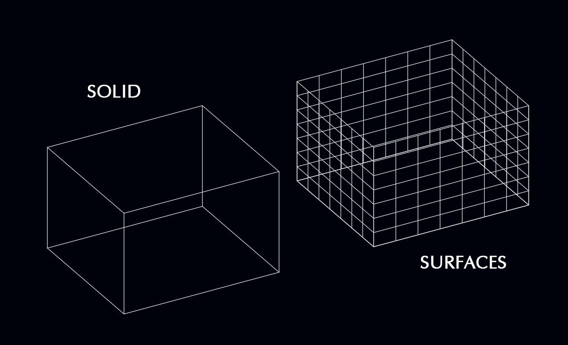

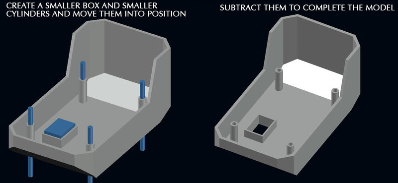

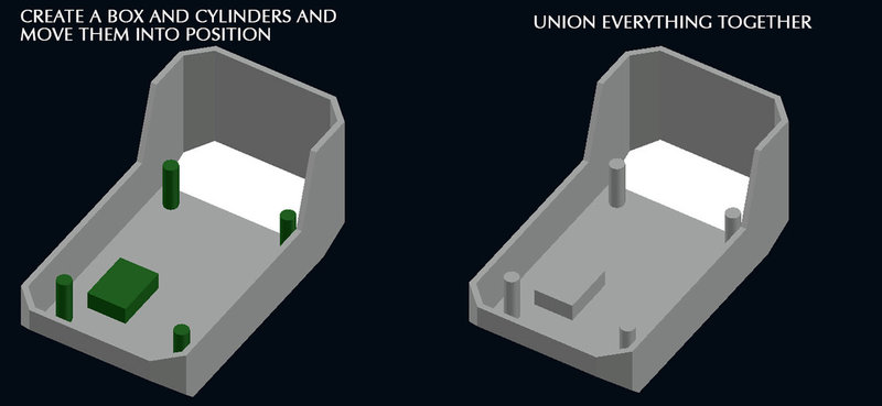

What command are you using when you try to "join" the objects? If you want to combine objects together you should be using the UNION command. As a test, I just tried to combine two solids that were not touching each other and the UNION command still worked, with no error message, even though there is a gap between the two objects. So I'm not sure what command you're using that's giving you that error message?
Also, just because you extruded your 2D linework, that doesn't mean you created a solid. If you extrude a single line or polyline, that will create a surface, not a solid.

There are no solids in your drawing just regions and surfaces, and your regions aren't coplanar  you are going to need to convert your drawing into solids, But I'll leave that to the big boys to help you. I only have LT so no experience with solids

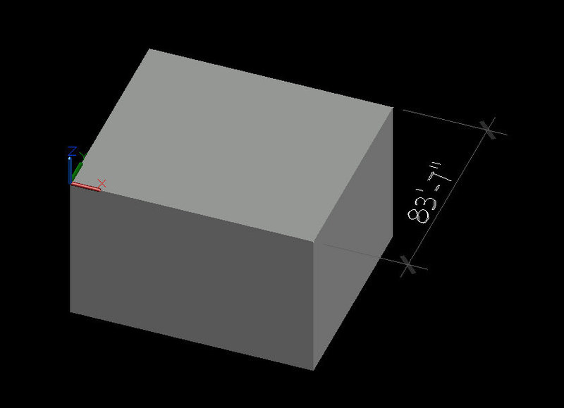

So If I make a square let's use 2" X 2" and close the polyline then extrude it to 2" It's not a solid?
So I made a test dwg. and done this but when I use convert to solid I get a error "Object cannot be converted." So I'm kinda lost. If an extruded object is not a solid and the convert to solid command doesn't turn it into one, I must be doing something wrong or not understanding exactly what a solid is or how to make one.

If you draw a closed polyline and extrude it then yes, it is a solid. If you draw the same shape using lines instead of a polyline and try to extrude you will get a bunch of surfaces.
If you try to run the CONVTOSOLID command on an object that is already a Solid you will get the "Object cannot be converted" error.

OK so now I know I did make a solid. Except mine came out with the color gray when it's extruded. I did all the objects in that drawing the same way.
I'm thinking about just creating a solid big enough to make the cover and kinda make cookie cutter insides and outsides and just subtract all what I don't need from it. But now this would require starting almost from scratch.
The sites that talk about the printer say it needs to be what they call "water tight" which I assume would mean the same as a solid. All I've done is some pre-programmed things to get the hang of the printer (Kinda). I'm new to that too so learning the printing and trying my hand at solids  I don't think now would be a good time to throw in Fusion 360.

Yours is gray because your visual style is set to "Shaded". I was working in "2D Wireframe" which is why mine is not gray.
Yes, Watertight means solid. Your current model is made up of Regions and Surfaces, so it is not watertight. If you try to export to .stl for printing, it won't work. You will have to recreate the model as a Solid in order to export it for printing.
