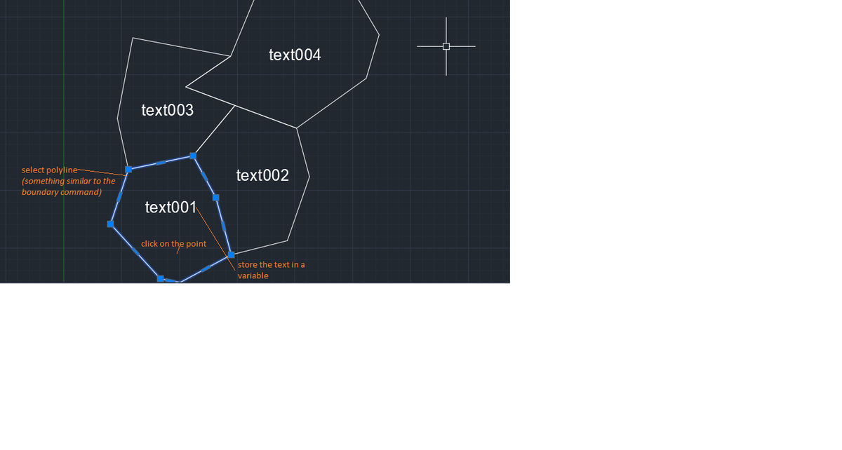

Hi guys, how can I save a text from inside a closed polyline in a variable.
I think this has already been answered but I haven't found anything on google,
I would like to click on a point and store the text inside that polyline in a variable.
Drawing1.dwg
How is selecting a point going to do that? Selecting a closed polyline would be easier otherwise you'll have to get a selection set of all closed polyline in the drawing then test each to find if the point is inside it, and if it is get the text. Selecting the closed polyline, you can just get the text.
@dlanorh
With this I can more or less select the closest polyline.
However, I need to select the text inside the polyline.
note: I only have a text in this layer inside the polyline

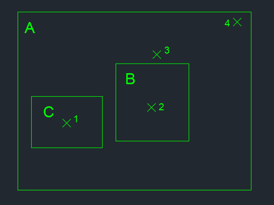

Just as dlanorh said, the routine Tharwat provided does not check if a point is inside a polyline, but rather the nearest polyline to the point.
Perhaps the below picture will give you a better idea:
Whatever is the nearest polyline to the X mark will be the one selected. If you choose 1, then C is returned. But if you choose 3, then B is returned because that's the closer polyline.
Also technically speaking, text B and C is also inside the outside larger polyline if this is your case, so clicking on Point 4 will give you some weird results.
But anyway, if you're following Tharwat's routine, then I've modified a few things

Let's calm... remember you said:
47 minutes ago, dlanorh said:
If you select a point and its closest point is on a common border of two polylines the distance to both polylines will be the same, and you therefore may get the wrong polyline returned.
That's the reason the result is not correct. When you do vl-sort, there are two distances that are the same value, so it doesn't know which point it's touching.
Ignore my code above, below is a more robust approach:
