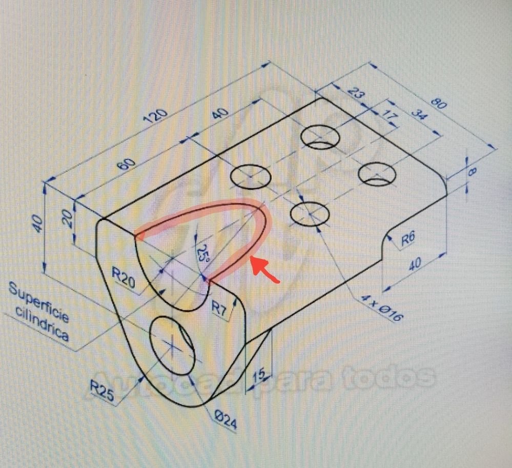

How can I draw or what command to use for the highlighted in red on the drawing.
"External link removed" - F7
Look at ellipse command. The red would be a trimmed 1/2. I take it your talking about a plan view not a 3d model.

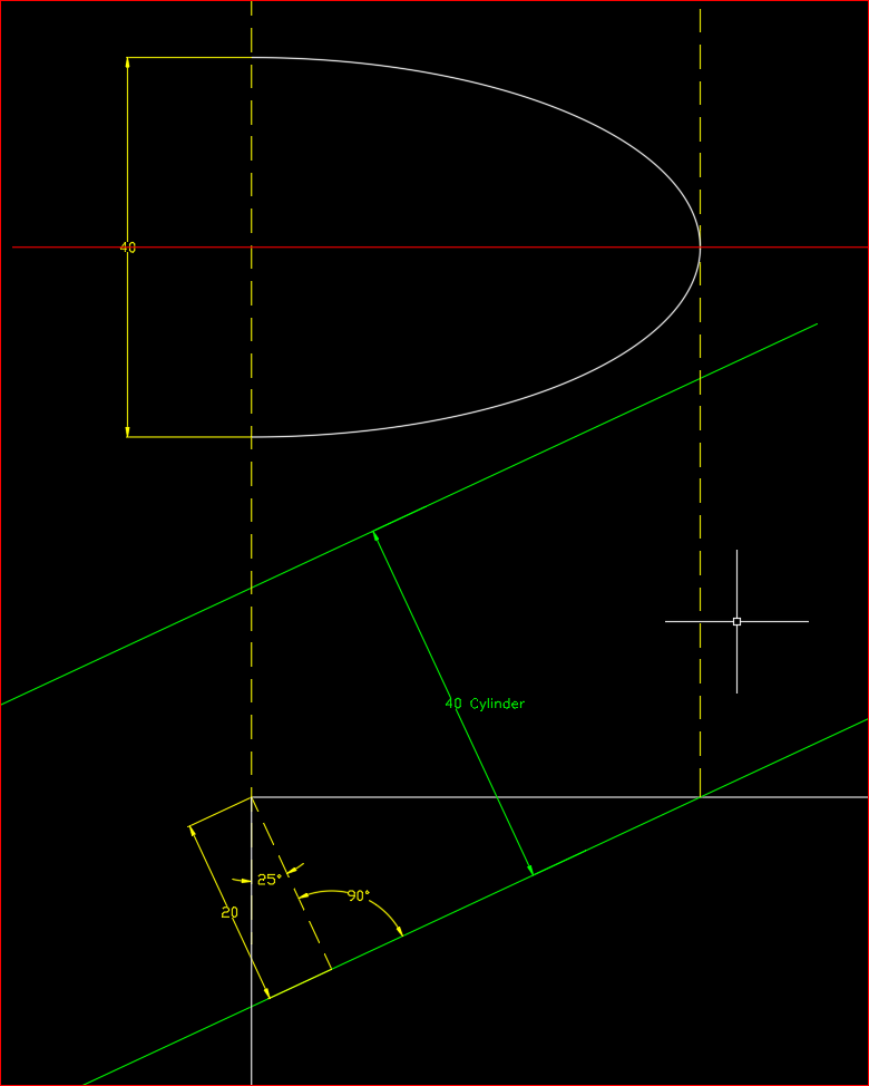

Just  a bit more info on how to set the ellipse out.
Ellipse would give a very good approximation, but this is a 2D isometric drawing of an ellipse on an isometric plane at an angle to the 2D plane. In Reality the cicles shown would be true ellipses, how you construct the isometric ellipse is beyond me, other than drawing it in 3D and then using an isometric view.
