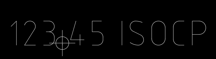

I actually want to transfer the elevation codes that are in the drawing  so that the insertion point falls on the dot point
Of course, this way I have to use the right font, which is a problem (I mean, the font that gives a space to all the characters)

As far as I can make out he wants either the insertion point of the text to be the decimal point, or to move the text so that the decimal point of the elevation text is over the node. No drawiing so otherwise clueless.
Think of it this way. using mono text its possible. Working out the width of each character may work. Compare 1 & 4

Getting the decimal point to match the insertion point is probably difficult. But aligning a column of texts so their decimal points are exactly below each other is possible with the textbox function. Get the width of "123.45" and of ".45" and use the difference to move the text.

Assuming a fixed width text style is not necessary - consider a text object with left justification and content "123.45", calculate the width of "123." using the textbox function and translate the object by this width to the left.

As BIGAL suggests, a textstyle can be changed, which would mess up the vertical alignment of the texts.
To get even more technical the decimal point moves depending on the font, some are at bottom, others say at mid height. Our surveyors have to use correct font for title work.
