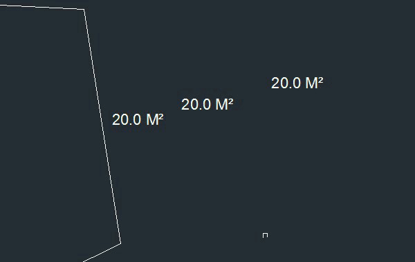

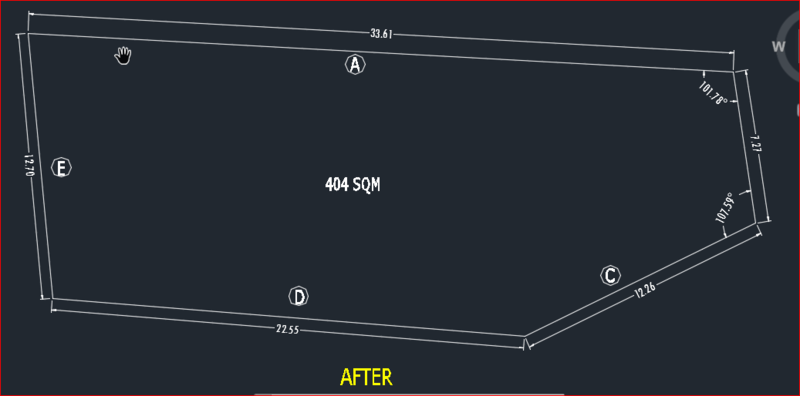

Hello everyone, I've a request for a lisp
1. which would scale a polyline to a certain area given by the user which could be bigger or smaller than original area.
2. The polyline should scale only in one direction, that is only one side of polygon/polyline should move  (user would select that side).
3. The side which would move, must maintain the angle of it's two adjacent sides/lines with respect to itself.
plz look at the images below for more clarity.

Its a iterative solution redo the pline vertices based for example on line A and C you move the points and get new area the increment would be small so area tolerance is met. I would pick the two corners, get their Vertice count then its a polar with correct angle. Don't have anything at moment but a hint add 1st vertice to verts list so forward back of 1st point can be calculated.

There's few possible solution,
1.as @BIGAL mentioned iterations
2.math solution (i have a 3-sides program using calculator)
3.simpson's rule but not sure..

Before doing some thing is the next question what about this also, The obvious is take an area and cut it into multiple areas using a method like a line brg. How many other scenarios ?

You take an area shape and imply a line at a bearing crossing the total area, then enter area required the line is now drawn subdividing the original area with the required area (respect to a tolerance to the area)

IMO geometry algorithm (tips: quadrilateral area) is faster than "guessing",
but coding with iteration inters is much easier
here i have a simple concept, just pick at one segment leg then slide.
the rest you can optimize..

Very nice @hanhphuc. 👍  You cannot select the first or last segment though, perhaps

Lisp here. There are many cases of line placement, so I have to check and correct the LISP for every situation
in this Lisp, there are messages on the screen, you just read and follow the request at the command line, don't care why it appears and it turns itself off.
If you expand the area, enter the positive area. If you want to “trim” the area, enter the negative area.
In some cases, if you enter a large area, the lisp will not work correctly, unexpectedly, try it and you'll see.

  On 3/29/2020 at 9:08 AM, xpr0 said:
Thanks for your effort.
I encountered some issues with this lisp.
1. It doesn't work on closed ploylines.
fixed
2. It prompts you to select a lwpolyline (unclosed), when i select a poly line i can move right & left and a new yellow boundary line appears but as soon as i click and zoom in or out the yellow line disappears.
just entmake polyline
3. It doesn't ask anything about area at all. like how much i want it to increase or decrease by.
of course, minimize user input debugging.
The area updates dynamically while moving your cursor, just left click mouse to create additional polyline
In the gif you posted above it increases the area by 20 SQM, but when i run this lisp it doesn't asks for that required area input.
code was just concept demo
Expand
as i said, since its structure is provided, it can be optimized to suit your needs.
please appreciate any afford (ideas, concept,  psuedo etc..) not just full code.
