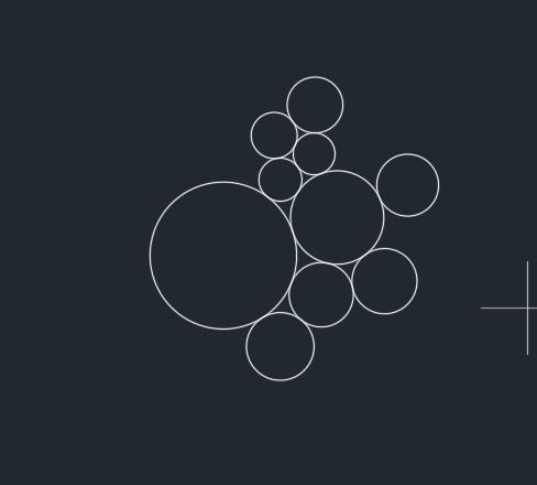

sublimation Posted March 22, 2020 Posted March 22, 2020 I need a little help with my code on two fronts. First, when I run my program I get my "Circle does not exist" error message constantly, even when I think the program should be finding two valid circles. I just can't see the issue. Second, without writing the code for me, could you show me where in my code I should be adding error checking, and what kind of error checking I should be looking into? This is my longest program to date, and I think I need to start getting a better grasp on how to stabilize my programs. Thank you all for your help! (defun C:BUBBLES (/ rn rmax RR r i pt1 ss tan-rs tan-ctrs c-obj cntrpt ptBx {ACADAPP} {ACADDOC} {MODELSPACE} LM:rand LM:randrange Pt->ssBB Pt->ssCircle PresicionRound SelectionSet->VLA-Object LM:inters-circle-circle) (setq {ACADAPP} (vlax-get-acad-object)) (setq {ACADDOC} (vla-get-activedocument {ACADAPP})) (setq {MODELSPACE} (vla-get-modelspace {ACADDOC})) ;; Rand - Lee Mac ;; PRNG implementing a linear congruential generator with ;; parameters derived from the book 'Numerical Recipes' (defun LM:rand ( / a c m ) (setq m 4294967296.0 a 1664525.0 c 1013904223.0 $xn (rem (+ c (* a (cond ($xn) ((getvar 'date))))) m) ) (/ $xn m) ) (defun LM:randrange (a b) (+ (min a b) (* (LM:rand) (abs (- a b)))) ) (defun Pt->ssBB (pt d) (if (not (listp d)) (setq d (list d d)) ) (mapcar '(lambda (s) (apply 'mapcar (list s pt d)) ) '(- +) ) ) (defun Pt->ssCircle (pt r n / rdns i ptlst) (setq rdns (/ pi (/ n 2)) ptlst '() i '0) (repeat n (setq i (1+ i) ptlst (cons (polar pt (* i rdns) r) ptlst)) ) ) (defun PresicionRound (n p / xn ) (setq xn (expt 10.0 (- p))) (* xn (fix ((if (minusp n) - +) (/ n (float xn)) 0.5))) ) (defun SelectionSet->VLA-Object (ssEnts / obj cnt) (if ssEnts (repeat (setq cnt (sslength ssEnts)) (setq obj (cons (vlax-ename->vla-object (ssname ssEnts (setq cnt (1- cnt)))) obj)) ) ) ) (defun LM:inters-circle-circle ( c1 r1 c2 r2 / a d m l x y mxv) (defun mxv ( m v ) (mapcar '(lambda ( r ) (apply '+ (mapcar '* r v))) m) ) (if (and (<= (setq d (distance c1 c2)) (+ r1 r2)) (<= (abs (- r1 r2)) d) ) (progn (if (equal r1 (setq x (/ (- (+ (* r1 r1) (* d d)) (* r2 r2)) (+ d d))) 1e-8) (setq l (list (list x 0.0 0.0))) (setq y (sqrt (- (* r1 r1) (* x x))) l (list (list x y 0.0) (list x (- y) 0.0)) ) ) (setq a (angle c1 c2) m (list (list (cos a) (- (sin a)) 0) (list (sin a) (cos a) 0) '(0 0 1)) ) (mapcar '(lambda ( v ) (mapcar '+ c1 (mxv m v))) l) ) ) ) (while (setq pt1 (getpoint "\nSpecify Location For Next Object: ")) (setq i '1 c-obj nil rn (fix (1+ (LM:randrange 1 30)))) (cond ; these percentages are weird - analyse, maybe add dcl interface and sliders to adjust the ratios ((< rn 21) (setq rmax 0.25)) ((> rn 24) (setq rmax 0.3125)) ((and (< rn 24) (> rn 20)) (setq rmax 0.50)) (T (setq rmax 0.75)) ) (setq RR '(PresicionRound (LM:randrange 0.125 rmax) 3) r (eval RR)) (while (< i 20) (while (and (< (if (not (setq ss (ssget "_CP" (Pt->ssCircle pt1 (+ r (* i 0.5)) 36) '((0 . "CIRCLE")(8 . "0"))))) 0 (sslength ss)) 1) (<= i 20)) (setq i (1+ i)) ) (if ss (progn (setq ss (SelectionSet->VLA-Object ss) ss (nth (car (vl-sort-i ss '(lambda (a b) (< (- (distance (vlax-get a 'center) pt1) (vla-get-radius a) r) (- (distance (vlax-get b 'center) pt1) (vla-get-radius b) r))))) ss) ss (ssget "_CP" (Pt->ssCircle (vlax-get ss 'center) (* (+ (vla-get-radius ss) (* r 2)) 1.02) 20) '((0 . "CIRCLE")(8 . "0")))) (if (>= (sslength ss) 2) (progn (setq ss (SelectionSet->VLA-Object ss) ss (vl-sort ss '(lambda (a b) (< (- (distance (vlax-get a 'center) pt1) (vla-get-radius a) r) (- (distance (vlax-get b 'center) pt1) (vla-get-radius b) r)))) ss (mapcar 'nth '(0 1) (list ss ss ss)) ;;; added extra ss incase the program later allows for 3 tangents tan-rs (mapcar '+ (mapcar 'vla-get-radius ss) (list r r r)) ;;; added extra r ... tan-ctrs (mapcar 'vlax-get ss '(center center center)) ;;; added extra center ... cntrpt (car (vl-sort (LM:inters-circle-circle (car tan-ctrs) (car tan-rs) (cadr tan-ctrs) (cadr tan-rs)) '(lambda (a b) (< (distance a pt1) (distance b pt1))))) ptBx (Pt->ssBB cntrpt (* r 1.1)) ss (SelectionSet->VLA-Object (ssget "_C" (car ptBx) (cadr ptBx) '((0 . "CIRCLE")(8 . "0"))))) (if (apply 'and (mapcar '(lambda (x) (if (<= (+ r (vla-get-radius x)) (distance cntrpt (vlax-get x 'center))) T nil)) ss)) (progn (setq c-obj (vla-AddCircle {MODELSPACE} (vlax-3d-point cntrpt) r) i '100) (vla-Regen {ACADDOC} :vlax-true) ) (setq r (eval RR) i (* i 2)) ) ) (setq r (eval RR) i (* i 2)) ) ) ) (if (and (>= i 20) (not c-obj)) (princ "\nCircle does not exist.") ) (setq ss nil) ) (princ) ) ) Quote

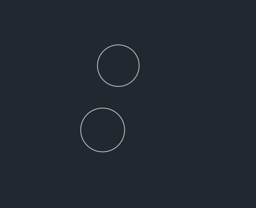

sublimation Posted March 22, 2020 Author Posted March 22, 2020 42 minutes ago, BIGAL said: Looked at code but did not run an image would have helped a lot, often tasks can be reduced in coding. A before after. My apologies. I have a tendency to forget to include important information that people need. It's a hard habit to break. (vl-load-com) is missing from the program. I always have it on in other programs and forgot to include it. Also, you have to start with two user made circles. First image. (I know, a pretty important detail.) When the program is run, you should be able to click in an open space and it creates a random tan tan circle at a point closest to your pick point. Creating the second image. Most of the time however, I just get my "Circle does not exist." error message. Please let me know if I've failed to included everything needed. Quote
sublimation Posted March 23, 2020 Author Posted March 23, 2020 34 minutes ago, lido said: What you expect to do your code? To debug, I recommend the function alert. I forgot to include valuable information. See above. It should run correctly the majority of the time, I just can't see why it doesn't create a circle the rest of the time. Quote
