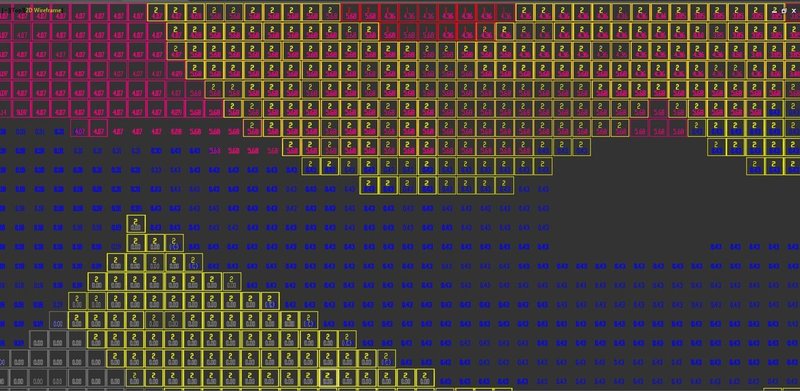

here is a sample image of the 1570 DWG files i am working on
originally the have all polyline boxes, but i deleted the other boxes to see the ones i needed to retain clearer
so i was thinking, maybe if i could ask some help to delete all the texts visible outside the polyline boxes.
it would help me a lot. my eyes are hurting trying to check the ones im deleting manually... please help me
Here is a dirty one:

It should place all the texts found inside rectangles in a new selection set called ssD. So run the program, then start an AutoCAD command (say Move or Delete) and when you are prompted to select the objects, type !ssd
Hope it works for you.
***** editing******
This will select all your texts inside rectangles. Sorry for that. Maybe you could use my program to select the texts to remain, move them on a hidden layer and delete the remaining ones... Sorry, I have no more time to rewrite the Lisp!
This one is very slow if there's heaps of data, but works. I won't recommend doing over 1000 objects or it will lag. Perhaps there's a better way to my approach.

Hi,
Give this shot and let me know.

thank you so much!
i tried the 3 routines,
the first 2 made my computer hangs, and it takes too long.
just like @Jonathan Handojo said. its not very effective on too much texts and polylines..
but @Tharwat routine is a bit faster. though it still takes time but atleast way lesser time than the previous routines.
thank you so much. this will cut my workload and increase my productivity
12 hours ago, Tharwat said:
(foreach itm lst (or (member itm txt) (entdel itm)))
I recommend changing this to vl-position. I've seen a search where  vl-position is at least  three times faster than member.
You're welcome. :)
