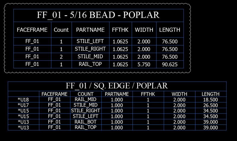

Hi Everyone,
I found this great lisp made by Bill Kramer, but I cant figure out the code to move the columns into the right position.  I'm attaching a screen shot of the table I would like to get & that is in the clouded area.  The table below that is the one being produced with the code attach.  I have several uses for this code and would like to know how to change locations of columns and to add n subtract as needed; also to add a specific table style to be used.
Thank
Joey G
