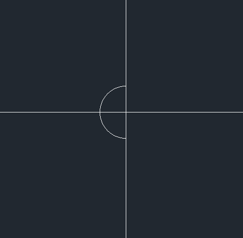

@Jonathan Handojo Thanks for the simplified program. It works fine but the result of your program is like as shown below

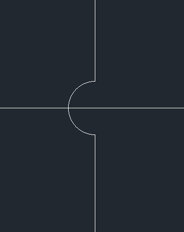

But i need result as below image. For this only i used trim command @dlanorh
I didn't thought you'd be doing that. I simply thought it was just an arc.
A better way to approach that is if you select all lines or curves) that "goes below" (or doesn't change), then select the one polyline to curve or "go above" as shown in your desired result.
With the help of LM:intersectionbetweensets by Lee Mac, this can be accomplished as shown in the gif below
Assuming that the "purple" lines doesn't go too close the vertex of the polyline to "go above", the code to do as such is below:

The arc is drawn under the assumption that the intersection point is a straight line, and thus the angle between the arc is 180. If you were to select it on a circle, you'll notice that the arc and line won't be in line, but I think this will be quite enough with what you need to achieve.

Another one here It's single pick but will keep the polyline intact.
Thanks a lot @Jonathan Handojo it works how i expect.
