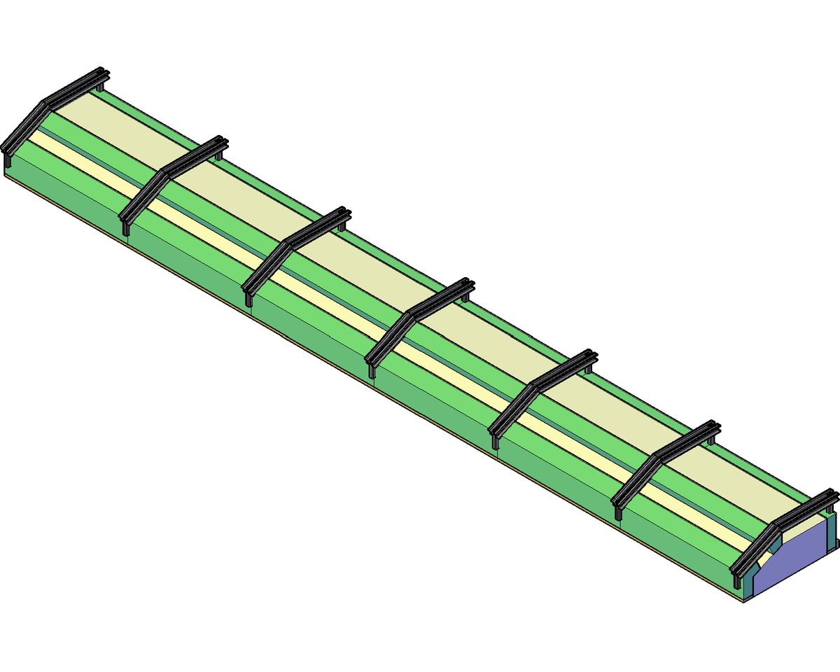

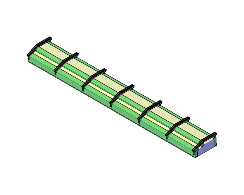

jim78b Posted March 10, 2020 Posted March 10, 2020 Why when i create a new view port in layout iwith same style (conceptual) i have different colors? model3d.dwg Quote

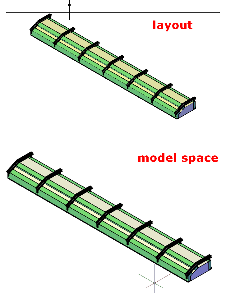

jim78b Posted March 10, 2020 Author Posted March 10, 2020 On 1/10/2020 at 12:54 PM, SLW210 said: What are the Computer and Graphics Specifications? Sorry i wrong post images. Try to see my dwg file .in model space and paper space ... Quote

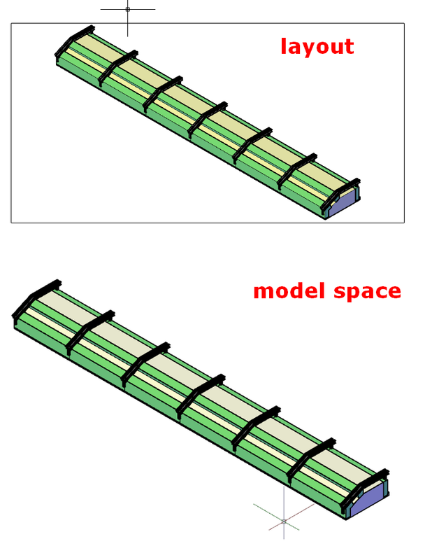

SLW210 Posted March 11, 2020 Posted March 11, 2020 That's what I posted, the top is Layout and the bottom is Model, both look the same to me, but I am getting old. I would guess it has to do with your computer, maybe someone else will chime in. Quote
steven-g Posted March 11, 2020 Posted March 11, 2020 Do you maybe use a different background color in model and paperspace? Quote
jim78b Posted March 11, 2020 Author Posted March 11, 2020 yes in model space i use rgb 240,235,214 in model space white Quote
steven-g Posted March 11, 2020 Posted March 11, 2020 rgb 240,235,214 is not white, AutoCAD does try and make up for differences in background color most noticably when you use a white color it changes that to black on a white background. It would be worth trying to set both backgrounds exactly the same. That might not be the cause but try it. 1 Quote
jim78b Posted March 11, 2020 Author Posted March 11, 2020 (edited) ok thanks very much but now i remember that i use white even in 3d wireframe Edited March 11, 2020 by jim78b Quote
