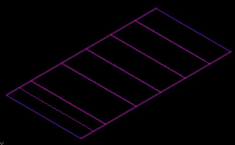

Haz Posted February 1, 2009 Posted February 1, 2009 Hello, I am trying to draw a 3d model of a 'ripple wall' (please see attached photo, its the background wall) It needs to be solid model that I can use for CNC manufacturing. I use Autocad 2007. The wall itself will be 20mm thick. Im not sure how to go about producing this, ive looked on here for other approaches but am still not sure how to create a smooth transition between the peaks and troughs. Any comments and ideas would be appreciated. Quote

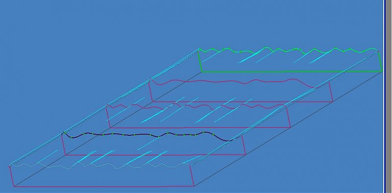

shift1313 Posted February 2, 2009 Posted February 2, 2009 okay so i did this real quick with no dimmensions but you get the idea. I used 5 cross sections(inventor 10 by the way). and no guide lines. I drew one cross section then copied it to two other planes. I then copied just the bottom and sides(straight lines) to two intermediate planes and drew different tops using another spline. This gave me the 5 cross sections and i just lofted between them. if you need me to go into more detail let me know. ps thats a solid and not a surface. Quote
shift1313 Posted February 2, 2009 Posted February 2, 2009 just another note. My cross sections were all very smooth by using a single spline. If you want to add hard edges to some cross sections and soft ones to other this will give you more of the effect you are looking for, but like i said quick and dirty, maybe 5 min drawing. Quote

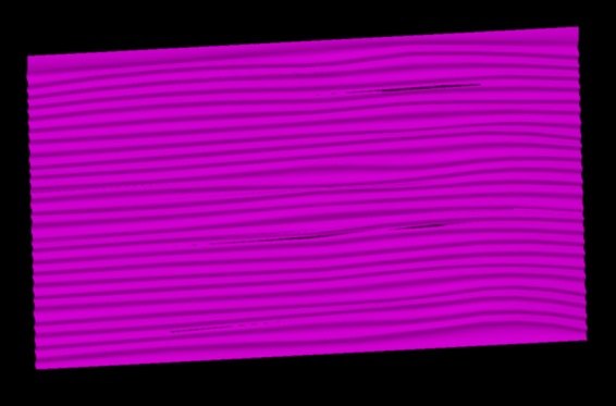

Haz Posted February 4, 2009 Author Posted February 4, 2009 Thanks for this, I can produce a surface but I dont seem to be able to create a solid shape. This is the surface ive created, which is getting close to what I want. But when I try to loft between certain elements to create a solid it doesnt work. Ive tried creating closed shapes and lofting between them but it wont work either....any suggestions? How was your solid created? Quote
shift1313 Posted February 4, 2009 Posted February 4, 2009 I didnt have the straight lines you do. you wont need them. Ill draw a cross section and show you. Quote
shift1313 Posted February 4, 2009 Posted February 4, 2009 I drew one last night in acad 09 and it worked fine but now in 07 its not working right. very odd. ill have to play with it a bit more. I basically drew 3 lines and a spline, then converted that to a region. i drew multiples like this and lofted between them and everything was fine and it created a solid. ill see if i can make some time to play with it. Quote

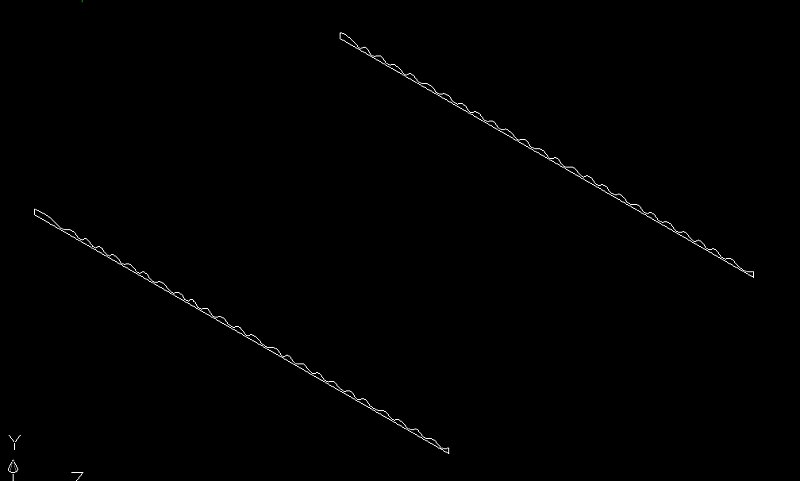

Haz Posted February 4, 2009 Author Posted February 4, 2009 Ive created to regioned shapes from the image before, but it says the 'selected cross section is not a valid type? Quote

aczeller Posted February 4, 2009 Posted February 4, 2009 i assume that you still haven't figured this out? if not, try this... this is the way that i would do it... draw the shape pretty much as a pixilated image... draw it with sharp edges and flat faces. i would use cubes/3d triangles, etc. stack them together in a relatively random pattern. just make sure that the base is solid when you are done. "union" them all together. now comes the fun part... figure out a fillet radius and do a 3d fillet on all the sharp edges. i would do the fillets a little at a time to minimize the risk of crashing the system. another option would be to make some splined poly-lines. make a few of them and randomly place them on the screen, all at the same elevation. make circles on the end, and extrude them along each path. once again, make sure all of your holes are filled in, then fillet the sharp valleys. the dimensions will probably take some trial-and-error to figure out what works and what doesn't, but that's the way i would go about it. let us know if that works or not. Later, Andy Quote
aczeller Posted February 4, 2009 Posted February 4, 2009 Ive created to regioned shapes from the image before, but it says the 'selected cross section is not a valid type?[ATTACH]9953[/ATTACH] are you sure that your faces are flat on the UCS? i've run into that issue before when the UCS is not properly aligned. Later, Andy Quote
shift1313 Posted February 4, 2009 Posted February 4, 2009 maybe its the difference between 07 and 08-09. 09 let me loft a region using lines and a spline. 07 will only let me do this if the curved line was created using arcs. try making your "wave" using arcs. Fillet the edges between the arcs, then use pedit to join all the arcs and your 3 straight lines. For some reason 07 doesnt let you loft with a region and im not sure of another way to make a close pline using a spline in 07. Quote
