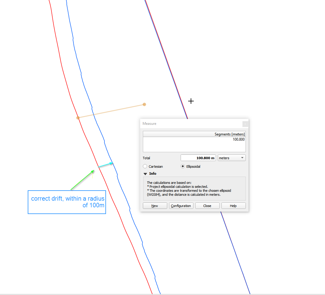

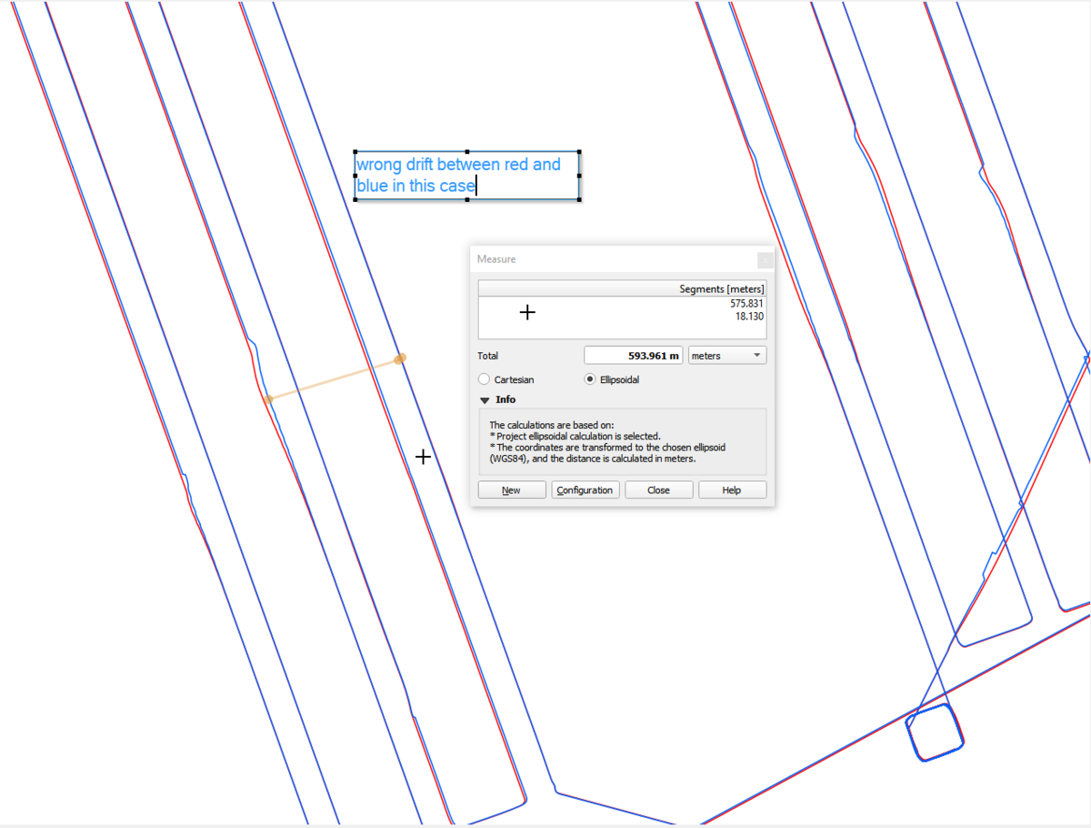

I have a plot of 2 navigations , red and blue, of 2 ships that are converging and diverging.  Most of the time they are almost parallel.
Is there a way to calculate the maximum drift along the 2 lines?    Even or also  in QGIS
NOTE -  the command must take into account   the drift over a certain range  only,  say on a 100m range, or else , as there are different passages of the lines,
the command would see also  the far most  drift from lines too far apart...please see the photos

No I haven't found anything similar, please note, as I explained, it  cannot be something that just keeps into account the distance between 2 lines, please see the screenshots... there are multiple passages of the lines same DWG, look at the first screenshot and you will understand why the lisp you suggested won't work.
thank you
You wanted the distance between 2 plines that's what I offered. With no dwg how are we meant to look further.
