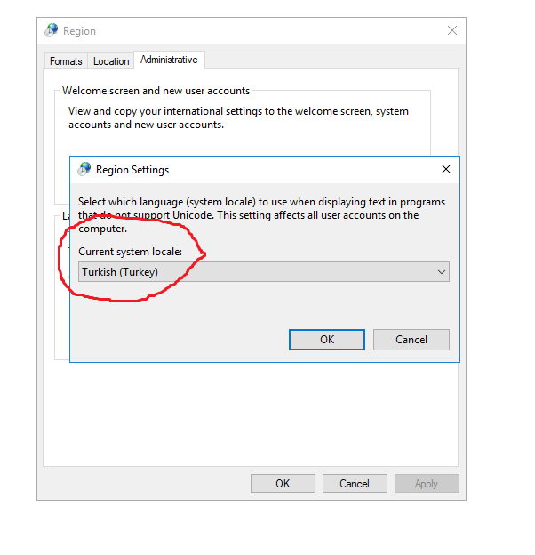

RepCad Posted March 8, 2020 Share Posted March 8, 2020 Hi all guys, Is there a way to get current system locate via autolisp? I need to read that from visual lisp. thanks in advanced. Quote Link to comment Share on other sites More sharing options...

RepCad Posted March 9, 2020 Author Share Posted March 9, 2020 (edited) Sorry lee mac, now I understand what you mean, but I couldn't find the key of system locate in "International" andو "sCountry" isn't what I need. Edited March 9, 2020 by amir0914 Quote Link to comment Share on other sites More sharing options...
pkenewell Posted March 9, 2020 Share Posted March 9, 2020 (edited) Perhaps (getvar "Locale")? If what you are wanting is the Language, then The AutoCAD setting would be the same would it not? In my system it is: (vl-registry-read "HKEY_CURRENT_USER\\Control Panel\\International\\User Profile" "Languages") EDIT or this? (vl-registry-read "HKEY_CURRENT_USER\\Control Panel\\International\\" "LocaleName") Edited March 9, 2020 by pkenewell 1 Quote Link to comment Share on other sites More sharing options...

RepCad Posted March 10, 2020 Author Share Posted March 10, 2020 (edited) On 3/9/2020 at 11:22 PM, pkenewell said: Perhaps (getvar "Locale")? If what you are wanting is the Language, then The AutoCAD setting would be the same would it not? In my system it is: (vl-registry-read "HKEY_CURRENT_USER\\Control Panel\\International\\User Profile" "Languages") EDIT or this? (vl-registry-read "HKEY_CURRENT_USER\\Control Panel\\International\\" "LocaleName") Thank you BIGAL, this code really helped me : (vl-registry-read "HKEY_CURRENT_USER\\Control Panel\\International\\" "LocaleName") Edited March 10, 2020 by amir0914 Quote Link to comment Share on other sites More sharing options...
BIGAL Posted March 10, 2020 Share Posted March 10, 2020 Yes returns true key value, "LocaleName" = en-au v's "sCountry" = Australia 1 Quote Link to comment Share on other sites More sharing options...
