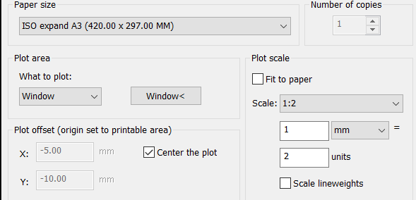

If you want check plot on a A3 laser etc when you plot just change the 1mm = 2 units and paper size this will produce a A3 I did use window as the title block needs to go up a mm or 2.
