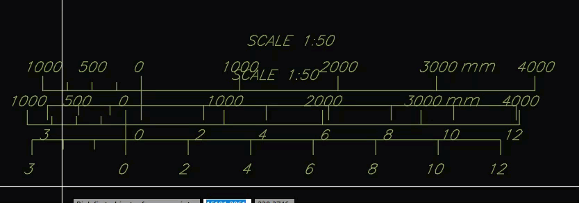

Hi Friends,
              i have bulk drawings which has been duplicated diagonally with a offset distance of 380.5mm,
is it possible to remove duplicated objects in diagonal as shown in below pic,
i tried overkill command but its not helping out, please someone help me on this task.

Give this a try. Not the fastest but better than nothing. 🍻

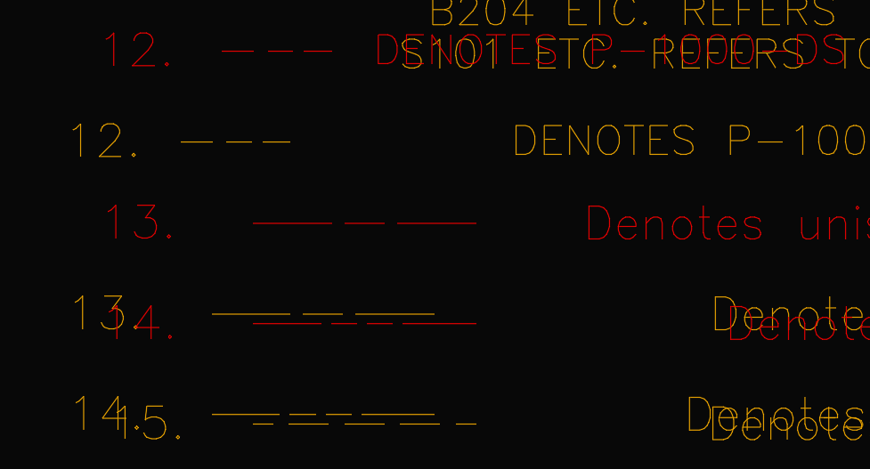

Hi Ronjonp,
                        Thank you so much for Understanding my query & prompt response on this task,
I checked the lisp in my drawing, its awesome, worked like a charm, it removed all the duplicates in drawings,
one small problem i found is, in some locations texts are not getting removed, i have attached the whole drawing itself, could you please
check & provide your valuable solution.
Edited by amb2301
That text is not an exact copy of the rest of the items. Do another reference point for them or up the fuzz value here (1e-1):
2 hours ago, ronjonp said:
(if (equal (car x) p 1e-4) x )
duplicated.dwg
Edited by ronjonp
Hi Ronjonp,
                            i  tried to remove the text by using another reference point, but its removing one text at that moment, not able to remove all,
is there any other way to overcome this problem
 Please help me.
Sorry. I can't do more for this. Looking at your last drawing the mess is too variable.
Hi friends, is there any lisp to remove this duplicated text alone?
Please help me on this task
The code I have is a good start ... but when there is inconsistent data how is one to know all the different scenarios to solve for?
Hi Ronjonp,
            Thank you so much, i have updated the  fuzz value to (1e-1):
its working now, its removing duplicates all over the drawing.
4 hours ago, amb2301 said:
Hi Ronjonp,
Glad it's working for you. 🍻
