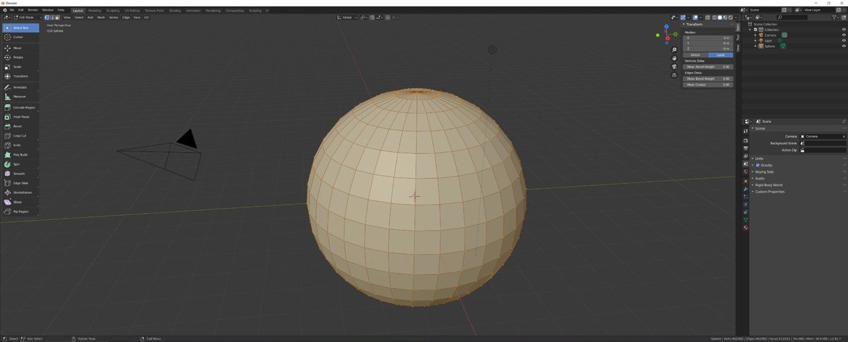

f700es Posted March 3, 2020 Share Posted March 3, 2020 Don't use a smooth sphere for one. Use a faceted sphere to give you vertex points. Here's one in Blender... Quote Link to comment Share on other sites More sharing options...
fuccaro Posted March 3, 2020 Share Posted March 3, 2020 Those vertices are not really equally spaced. I don't think there is a general solution, however in particular cases you can find those points. Let's consider a regular polyhedron. All the corners are equally spaced on the circumscribed sphere. Now if we place an additional vertex, probable there is no way to rearrange the vertices to met the equally spacing criteria. Quote Link to comment Share on other sites More sharing options...
