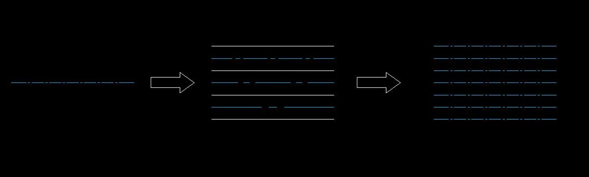

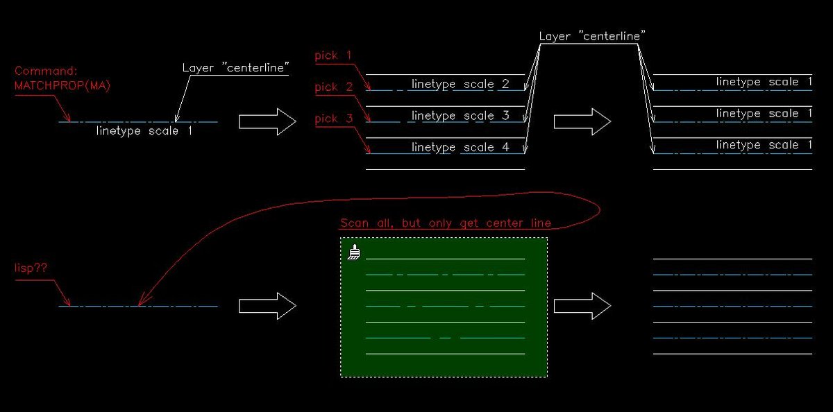

Hi all,
In a drawing there is a class, but in that layer contains many different properties. I want to synchronize them into an attribute according to the attribute I choose as a template. Want to describe but it's hard to understand, Something similar to the image I have attached below.
can somebody help me please?
thanks

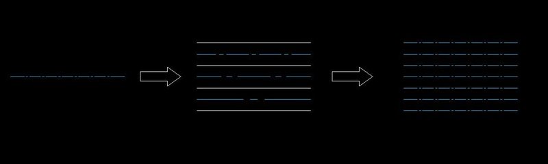

thank you for your reply! I tried it and it didn't work as expected. the problem is: The entire selected object has changed!
Please check it for me!

OK. With a drawing I can see why the first version didn't work properly, mainly through my stupidity. :cry:
Try this.

This will only select lines on the same layer as the "template" line.

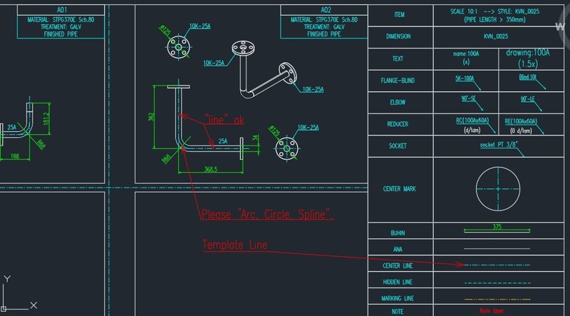

good good good. It works very well, Thanks very much!!!
After using it I want it more than that, You help me develop more functionality for it
I want it to accept arc, circle, splines...It would be great if it worked like that. Please help me again
pipe.dwg
(vl-load-com)

If I've missed something let me know
