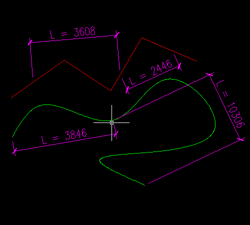

Here's my immediate problem, im putting chainage lines off the centerline of a road and i need to find out how far to come around the curve in the road. eg i start a one end of a curve and i need to put a chainage line 5m around the curve.
whats the best way to do that? Help!

I found a way,which included drawing an arc using the center point of the curve on the road then specifying the lenght:)
But if anybody knows an even easier way to do it dont be afraid to jump in!
Use the command MEASURE, and make sure that the POINT is set as a visible mode :)
OR you can create a block containing the information you wish to show as your chainage. then use measure, but use block, then your distance along the curve you wish to place your chainage at
you could:
OFFSET your curve
DRAW 'POINT' at one end
ARRAY that point
(I think, can't check on this laptop)
Maybe...
(defun c:cdim(/ cCurve obType lEnt vlaDim pt1

(princ "\nType CDIM for curve dimension ")
