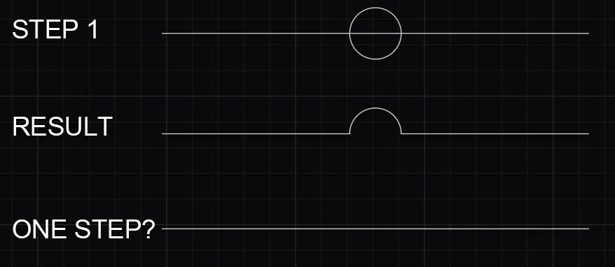

LITOKARDO_BC Posted February 19, 2020 Share Posted February 19, 2020 Good morning to all the communication, you could help with a necessary LISP to trim then join. Send example. Thank you EXAMPLE TRIM TO JOIN.dwg Quote Link to comment Share on other sites More sharing options...
LITOKARDO_BC Posted February 19, 2020 Author Share Posted February 19, 2020 2 hours ago, LITOKARDO_BC said: Good morning to all the communication, you could help with a necessary LISP to trim then join. Send example. Thank you EXAMPLE TRIM TO JOIN.dwg 75.16 kB · 0 downloads (defun c:C6() (setq PT (getpoint "Center")) (command "circle" PT "0.06") (command "trim") ) Quote Link to comment Share on other sites More sharing options...
ronjonp Posted February 19, 2020 Share Posted February 19, 2020 Try this perhaps. (defun c:hop (/ a b d e ent i o p1 p2 p3) ;; RJP » 2020-02-19 ;; Set below for hop size (setq a 0.5) (while (setq ent (entsel "\nSelect polyline to add hop: ")) (cond ((= (cdr (assoc 0 (entget (setq e (car ent))))) "LWPOLYLINE") (setq p1 (vlax-curve-getclosestpointto e (trans (cadr ent) 1 0))) (setq i (fix (vlax-curve-getparamatpoint e p1))) (setq b (vla-getbulge (setq o (vlax-ename->vla-object e)) i)) (setq d (vlax-curve-getdistatpoint e p1)) (vlax-put (vlax-ename->vla-object (tblobjname "layer" (vla-get-layer o))) 'lock 0) (if (and (setq p2 (vlax-curve-getpointatdist e (+ d a))) (setq p3 (vlax-curve-getpointatdist e (- d a))) ) (cond ((= (fix (vlax-curve-getparamatpoint e p2)) (fix (vlax-curve-getparamatpoint e p3)) i) (vlax-invoke o 'addvertex (setq i (1+ i)) (mapcar '+ p2 '(0 0))) (vlax-invoke o 'addvertex i (mapcar '+ p3 '(0 0))) (vla-setbulge o i (if (< (angle '(0 0 0) p2) (angle '(0 0 0) p3)) -1. 1.) ) ) ((princ "\nVertex overlap! Pick another point...")) ) ) ) (princ "\nObject needs to be a lwpolyline...") ) ) (princ) ) Quote Link to comment Share on other sites More sharing options...

LITOKARDO_BC Posted February 19, 2020 Author Share Posted February 19, 2020 (edited) THANK YOU FOR THE SOON ANSWER, IT IS POSSIBLE TO INDICATE THE ARC DIAMETER, AND PRESISE THE POINT OF INTERSECTION. SEND A GIF BY GOOGLE DRIVE. THANKShttps://drive.google.com/file/d/126bvy7_lAzTiZ81TAvlJb2Cx24vCLupH/view?usp=sharing Quote Edit Quote Edited February 19, 2020 by LITOKARDO_BC Quote Link to comment Share on other sites More sharing options...
ronjonp Posted February 19, 2020 Share Posted February 19, 2020 Try this to set the hop size .. I don't have time at the moment to do the precision for you. (defun c:hop (/ a b d e ent i o p1 p2 p3) ;; RJP » 2020-02-19 ;; Set below for hop size (setq a (/ (cond ((setq a (getdist "\nEnter hop size: "))) (1) ) 2. ) ) (while (setq ent (entsel "\nSelect polyline to add hop: ")) (cond ((= (cdr (assoc 0 (entget (setq e (car ent))))) "LWPOLYLINE") (setq p1 (vlax-curve-getclosestpointto e (trans (cadr ent) 1 0))) (setq i (fix (vlax-curve-getparamatpoint e p1))) (setq b (vla-getbulge (setq o (vlax-ename->vla-object e)) i)) (setq d (vlax-curve-getdistatpoint e p1)) (vlax-put (vlax-ename->vla-object (tblobjname "layer" (vla-get-layer o))) 'lock 0) (if (and (setq p2 (vlax-curve-getpointatdist e (+ d a))) (setq p3 (vlax-curve-getpointatdist e (- d a))) ) (cond ((= (fix (vlax-curve-getparamatpoint e p2)) (fix (vlax-curve-getparamatpoint e p3)) i) (vlax-invoke o 'addvertex (setq i (1+ i)) (mapcar '+ p2 '(0 0))) (vlax-invoke o 'addvertex i (mapcar '+ p3 '(0 0))) (vla-setbulge o i (if (< (angle '(0 0 0) p2) (angle '(0 0 0) p3)) -1. 1. ) ) ) ((princ "\nVertex overlap! Pick another point...")) ) ) ) (princ "\nObject needs to be a lwpolyline...") ) ) (princ) ) Quote Link to comment Share on other sites More sharing options...
