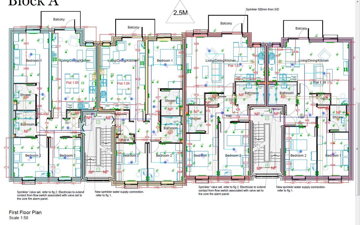

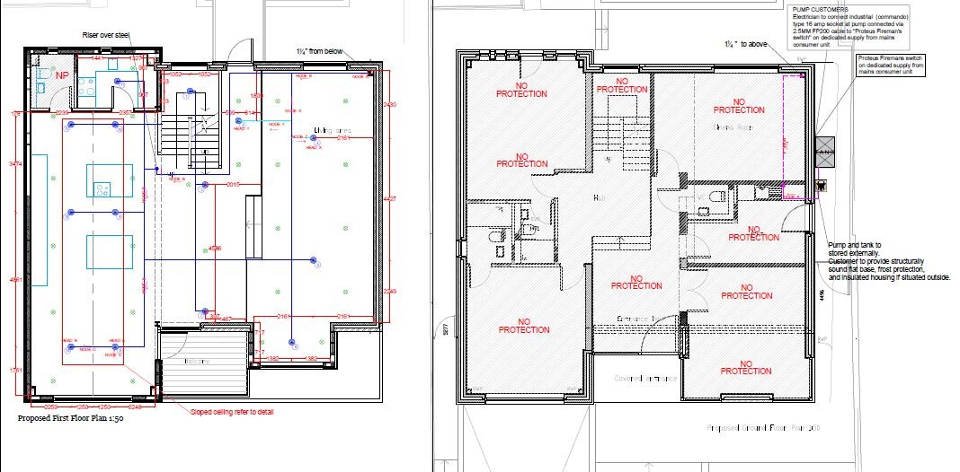

Hi, thanks for your response. I have attached 2 examples of drwings one is for a single house and another is a single floor of a couple of adjoining blocks of flats. The different coloured pipework corresponds to different pipe sizes. Let me know if you require further information - thanks

What you want has been done before its very easy to get the total of all lines, plines arcs circle etc on a layer, I have suggested layer rather than colour as you posted an image not sure.  The question to this is display on screen, in a table or output to a file or all ? There are lots of examples out there.

ok 1st up use wblock when posting dwg's, your dwg is 4Mb my wblock of the same is 135kb.  Just wblock what is required.
Looking a your dwg as the pipes are on 1 layer that is ok but me I would have had like RAD Sprinkler Pipework-50, RAD Sprinkler Pipework-38 so know the dia of pipe, a better way than just using colour to distinguish. Can be converted from colour to layer.

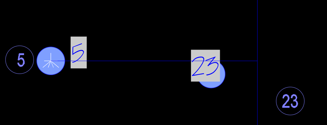

You can tie the label number to the sprinkler with a hidden attribute using a Field in the attribute it will then read the number and save in the block if needed, so could get stuff like sprinkler number,X,Y. You would do this at time of creation. www.Lee-mac.com, Lee has a good autonumber lisp that if you remove one it will renumber so I would be looking at using that.
You would make the head-number attribute  invisible so would not see twice. A more advanced method may be a dynamic block so it links the sprinkler with the number, has rotation and offset built in. Some one may be able to do that block for you a better 1st step as the 2 objects are one. I am not that good at dynamic blocks.
