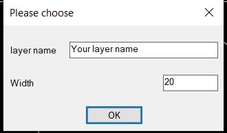

BIGAL Posted February 14, 2020 Posted February 14, 2020 (edited) I have a lisp that I am trying to work out the last step it allows you to do any width by type P23 ie a pline 23 wide you can type P plus any number. It makes a new pline with a width but you could edit it and do a is it a line or a pline then pedit the entity. For any one interested see code attached problem is in color option. What about something like this. The multi getvals can be changed so it remembers the layer and width. (defun c:pedwid ( / ans entis lay wid ) (while (setq ent (car (entsel "\nPick an object to make pline width:"))) (setq entis (cdr (assoc 0 (entget ent)))) (if (not AH:getvalsm)(load "Multi Getvals.lsp")) (setq ans (AH:getvalsm (list "Please choose" "layer name " 25 24 "Your layer name" "Width " 8 7 "20" ))) (setq lay (nth 0 ans)) (setq wid (atof (nth 1 ans))) (cond ((= entis "LINE")(command "Pedit" ent "Y" "w" wid "")) ((= entis "ARC")(command "Pedit" ent "Y" "w" wid "")) (if (= entis "LWPOLYLINE")(command "Pedit" ent "w" wid "")) ((Alert "Object chosen can not be made into a pline")) ) (command "chprop" (entlast) "" "LA" lay "") ) (princ) ) (c:pedwid) Multi GETVALS.lspFetching info... pline arc offset.lspFetching info... Edited February 17, 2020 by BIGAL Quote
masterfal Posted February 14, 2020 Author Posted February 14, 2020 thats pretty cool. converts to polyline with thickness but doesn't seem to want to change layer? just puts it in whatever the current layer is Quote

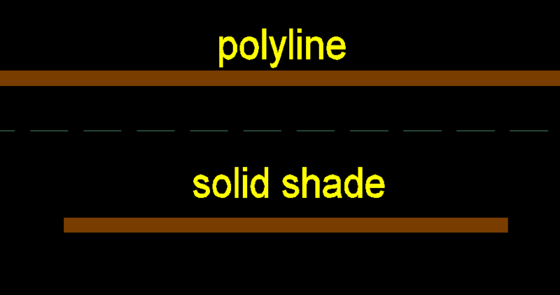

masterfal Posted February 17, 2020 Author Posted February 17, 2020 ahhhh damn it. may have done this for nothing.. didn't realise thick polylines don't print out the same as a solid shade even though they look identical on screen.. is this normal? on screen: print: Quote
BIGAL Posted February 17, 2020 Posted February 17, 2020 Never had a problem is the pline a linetype other than continuous ? What are you plotting to ? Maybe others have seen this problem. Quote
Roy_043 Posted February 18, 2020 Posted February 18, 2020 Maybe the OP uses STB instead of CTB? Quote
