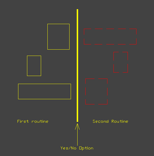

I don't know how to put it in words. Let say i'm done with the first routine and i want an option to stop there OR continue to second routine. If i pick NO it will ends the whole LISP without making the second routine but if i pick YES it will continue to second routine.

Tried making a new (defun) and inserted these code:
(defun Opt ()
(initget "Yes No")
(setq kw (getkword "Proceed to next routine? [Yes/No] <Yes>: "))
(cond
  ((or (not kw) (= "Yes" kw)) (acTitikPertama))
  ((= "No" kw) (alert "This is defun Opt"))
(defun acTitikPertama ()
  (alert " I'm in acTitikPertama!")
When i choose NO, it stil jump to (defun acTitikPertama). Not like my previous code in a WHILE, this is totally in defferent defun. It did not END the LISP.
Is it because acTitikPertama is  in my main run (defun c:KK() ? I don't think thats the problem because sometimes the LISP need to run acTitikPertama.
(defun c:KK ()
 (Opt)
 (acTitikPertama) ;<----- Exist here!
 (NewDitk)
Can somebody help me...anybody please. This driving me nuts.

Thank you for your reply @hanhphuc.  But will  acTitikPertama still run even without making in the list? I do apologize for these question. Even the simplest thing like Defun and global, i still trying to understand......
@hanhphuc, it works! Thanks a million. Can you please explain, any other condition when should i avoid calling a defun in the main list? BTW, the c:KK, what is the right term for it? Main programme? Main defun list?
