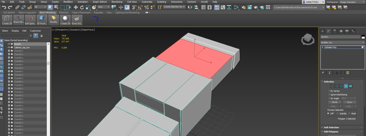

Hi,
I recently installed 3ds Max 2020 and I cant find the  Graphite/ Polygon Modeling tab on the ribbon. I have tried reverting to startup layout and turning the ribbon on an off. I also have  editable poly object selected, but still the tools does not show up. I've tried seraching in max help and customize the ribbon without any luck. It is probably a really stupid small setting somewhere, but I cant find it. Anyone had same problem? Or have a solution?
The only available tabs on my ribbon is : Get Started, Object Inspection, Basic Modeling, Materials, Object Placement, Populate, View and Lighting and Rendering
I have also googled for days without getting any wiser, please help  ;)
Thanx,
Brita
Edited by Brita
I haven't used 3ds max in years, but what happens if you right click up in the ribbon area, where you drew that question mark? Do you get any options for hiding or showing panels?

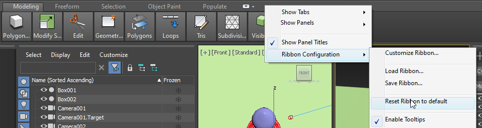

Hi there! Some one have an answer? I am looking for the freeform bar, but I can't find it in 3ds Max 2020.
I leave you the solution: At the ribbon tab press Right click > Ribbon configuration > Reset ribbon to default.
Automatically, the Freeform will show up in the tootlbar.
