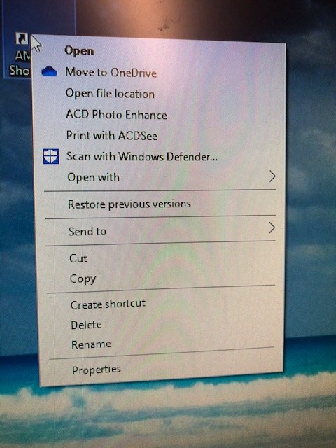

I am attempting to drag a ttf font file from my desktop into the font folder of Win 10.  I receive a message
saying that it does not appear to be a valid font.

tombu,
Thank you for your response.  I downloaded the ttf file from  dafont.IMG_1059 - Shortcut.lnkcom.
This is the drop down I receive at a RMB.

tombu,
Thanks for your response.  I downloaded the ttf file from dafont.com.  This is the
result of a RMB.

50 minutes ago, gotchy said:
This is the result of a RMB.
When I look at your screenshot, it appears that you are right clicking on a shortcut, not the actual font file. You need to right click on the font file in order to install it. I assume that's probably why drag and drop is failing also. If you're dragging and dropping that shortcut, it's not going to work. You need to grab the actual TTF file.
I was referring to actually trying the suggestion instead ruling out from a Google search but it appears that something else is going on and that is not the font file.
Try going to file location.

On 2/9/2020 at 12:39 PM, Cad64 said:
I believe RobDraw was asking if you tried my suggestion about right clicking on the font and installing it that way. It wasn't clear from your reply if you tried what I suggested or just read what Google said and didn't try it.
 Yes I did try RMB, I did not get the option to install.  I downloaded the files from another source and was able to drag and drop the files into the font libraryI want to thank all you gentlemen for your responses.  I'm sure you know that your responses are invaluable to a beginner. Thanks again   Andrew Gotcheski
