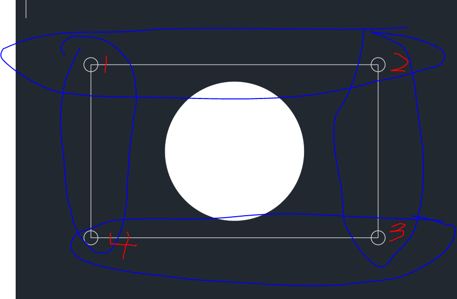

Been blowin y'all up the last couple days. Just want to say thanks for everything, and ask yet another question. What's the best way to go about generating an attribute field that references other blocks to perform a calculation? From what I've found, vla seems to be the answer. Can someone help me get started? I want an attribute field to reference pairs of points to calculate a difference in elevation between two points as shown below.
I have been able to do this manually, but I need to write a routine that will build my block automatically and set all attribute fields. From what I have found it can be impossible to entmake the attribute field. If I can't use entmake, then will i need to use vla functions? If I use vla functions, then I assume I will need to convert back to entity's once done with creating. Or do I need to keep everything as vla?
The formula would be (z2-z1)/(x2-x1)*100 to yield a slope percentage. I'd do this for every pair of points.
Any help would be appreciated.

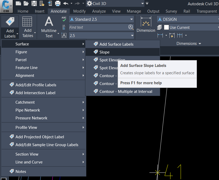

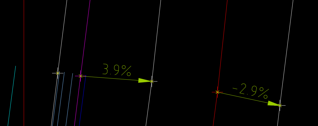

Isn't this what you want, you can customise the style. No code produced image. It could possibly be automated, but manually only takes seconds. Just convert points to a cogo point on a surface so Z is auto worked out.
Edited by BIGAL
It's close, but based on the slopes i need to be able to change the color of a block for quick visual inspection.
