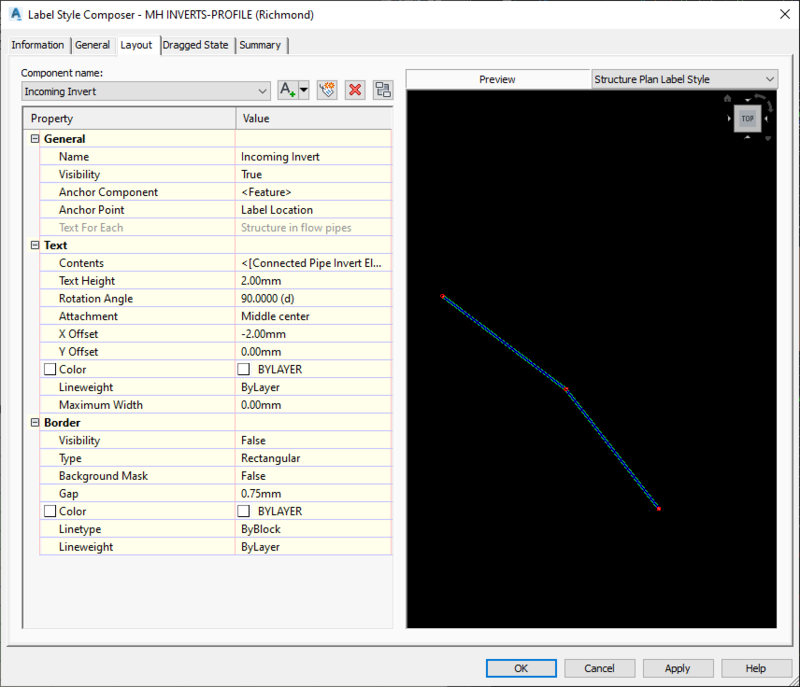

   At my former workplace we had invert labels for the profile view of our manhole structures.  If the label came in backwards showing the South Invert first and the North Invert second and we wanted to flip it around, it was a simple switch to a child style that flipped the label around.  I've set up something similar here at my present work place but for the life of me I cannot get it to change the order of inverts.
    I've set an incoming invert style,
And an outgoing invert style
You would think  you could move the text around changing the x offset but nooooo.  Civil3d moves BOTH like some digital Siamese twin.  Stuck together in the same wrong frigging order.  Is there any way to set this up so all I have to do to flip it around is to choose a different style?  Really wish I could cheat and open up my old workplace drawing and see how they did it...
