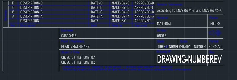

PeterPan9720 Posted January 22, 2020 Share Posted January 22, 2020 Hi, I don't understand very well what do you mean, but if you are trying to modify a sort of "company template", you can ease create a block with attributes, (CUSTOMER, JOB NUMBER Release, and so on and modify it with VBA for sure. See attached Jpg image Quote Link to comment Share on other sites More sharing options...

barakar42 Posted January 23, 2020 Author Share Posted January 23, 2020 Apologies for not being clear. I've attached a screenshot of our border and the lisp program that i'm using In the lisp program, i've specified what block to be looking at, our borders. So to run the command you'll type "coa" then it will ask for text that you want to replace and the it will ask you for the new text that you want. Its the final part that i cant get working. VBA will send the command, the #'s but i then can't get e cell value to be put into the command line to change the #'s All the text that i'll will be replacing will have a varying number of #'s in and they will be the same across up to 60 drawings. fr.lsp Quote Link to comment Share on other sites More sharing options...
PeterPan9720 Posted January 23, 2020 Share Posted January 23, 2020 Hi Thank you for explanation, I guess that with a Block with all information as attributes inside you can solve very fine your issue. You can create a VBA form, where it will be required the text to be change, after this step procedure will search inside the drawing the drawing information title block, search attributes (text) to be change, and you solve your problem. Blocks attributes could be changed also by hand with double click directly on block inside drawing and you can change the attributes containing the text to be change. Send me an empty drawing I'll try to explain you better what I mean, than you can decide. Regards Quote Link to comment Share on other sites More sharing options...

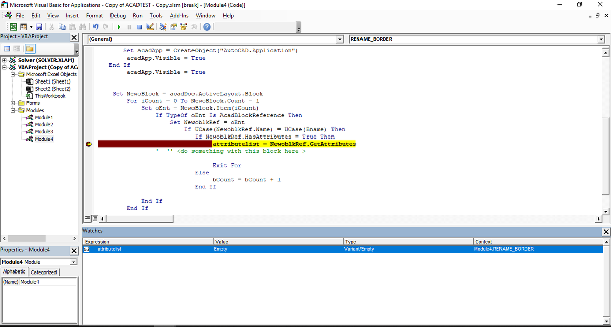

PeterPan9720 Posted January 24, 2020 Share Posted January 24, 2020 (edited) 33 minutes ago, barakar42 said: Where does the attribute list get saved so i can check which attributes i need to change? Also, is it possible to only change part of an attribute, e.g C####-E-000 to C1234-E-000 All attributes are stored in AttributeList array, during routine debug you can check which is the attributes you need to change see picture above, check the properties AttributeList(XX).TAGSTRING for information on NAME of Attribute and AttributeList(XX).TEXSTRING for modification. For modification you can insert: If AttributeList(6).TEXTSTRING="C####-E-000" then ' DRAWINGNO SHALL BE at position 6 of AttributeList array check with debug. AttributeList(6).TEXTSTRING="C1234-E-000" end if Of course Attribute value it's a string so you can manipulate as you need, it's could be from excel cell value, or LEFT("XXX", CharPos) or MID, or RIGHT. I hope above could solve your issue. Edited January 24, 2020 by PeterPan9720 Quote Link to comment Share on other sites More sharing options...
barakar42 Posted January 24, 2020 Author Share Posted January 24, 2020 (edited) I understand that you have to run the program and "watch" the attributes to see the full list of them all, but when i try , it doesn't appear in a list like what you get. I'm probably doing something wrong, i've not got much experience with VBA yet Edited January 24, 2020 by barakar42 Quote Link to comment Share on other sites More sharing options...
PeterPan9720 Posted January 24, 2020 Share Posted January 24, 2020 16 minutes ago, barakar42 said: I understand that you have to run the program and "watch" the attributes to see the full list of them all, but when i try , it doesn't appear in a list like what you get. I'm probably doing something wrong, i've not got much experience with VBA yet Ok let explain goto into editing of code on row AttributeList = NewoblkRef.GetAttributes and type function key F9 so you insert a break (you will see a red row) of procedure when it is running and will pass on that point of code. Run the procedure and when break point will be reached click with right mouse button and select add watch option. On VBA software you will have a debug windows where you can see the "watched" variable. Click on the + sign on visible variable on that window and you will have all properties of selected variable (see picture on previous post). Search the attributes name in TAGSTRING property value, and then you can modify the TEXTSTRING property value for change it as I showed you before. Quote Link to comment Share on other sites More sharing options...
barakar42 Posted January 24, 2020 Author Share Posted January 24, 2020 I've followed those steps, but on the watch list, it says value is empty and there's no option for the plus icon Quote Link to comment Share on other sites More sharing options...
PeterPan9720 Posted January 24, 2020 Share Posted January 24, 2020 (edited) 6 minutes ago, barakar42 said: I've followed those steps, but on the watch list, it says value is empty and there's no option for the plus icon Let the procedure execute the code in row because when you break on a specific row this will be not executed. Press F8 function key and watch again. And press F5 to run again until next breakpoint will be reached again. Edited January 24, 2020 by PeterPan9720 Quote Link to comment Share on other sites More sharing options...
