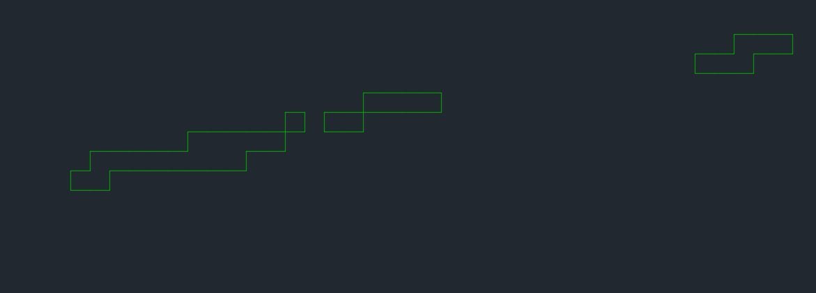

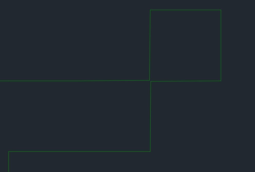

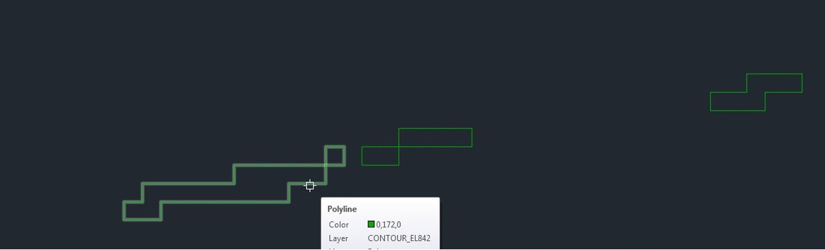

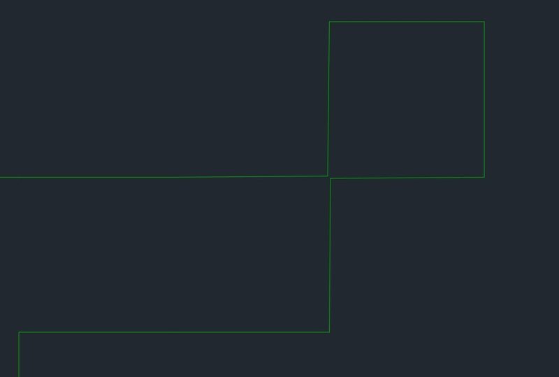

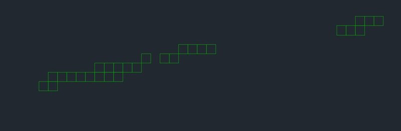

ScoRm Posted January 22, 2020 Posted January 22, 2020 (edited) ok, the title is kinda stupid... but let me explain what i need i have multiple DGW files containing boxes of 3dpolylines like this those are individual boxes, and i need it to look like this... what i do here is EXPLODE them so the 3dpoly becomes lines, and therefore easier to select and manually delete everything inside. and after that i join them all so they will become a single polylines thats pretty much it! but i have a consern... what about the ones that meet on the center. well i just move them before i join themall together like this see? its a single polyline... and here is what my consern looks like up close.. as you can see i just move them so they dont touch each other... is there a way or a lisp routine that could help me do this? Edited January 22, 2020 by ScoRm Quote

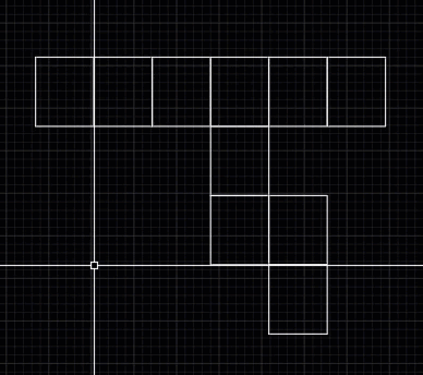

rlx Posted January 22, 2020 Posted January 22, 2020 think you can do something with the boundary option from the hatch command or maybe even http://www.lee-mac.com/outlineobjects.html Believe something has been asked before on this forum but you'll have to search for something like outline or boundary Quote
ronjonp Posted January 22, 2020 Posted January 22, 2020 (edited) You can also use the REGION then UNION command .. but Lee's outline code is easier :). Edited January 22, 2020 by ronjonp 1 Quote

ScoRm Posted January 23, 2020 Author Posted January 23, 2020 15 hours ago, rlx said: think you can do something with the boundary option from the hatch command or maybe even http://www.lee-mac.com/outlineobjects.html Believe something has been asked before on this forum but you'll have to search for something like outline or boundary i did try leemac's, it does outline the outer lines, but it removes the elevation; it becomes elevation 0 but thanks for the tip. I will try to figure it out... Quote
