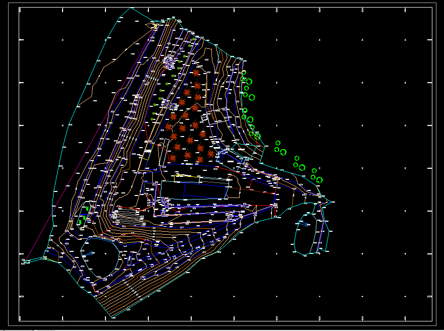

Is this what you are tying to bring up on your screen?

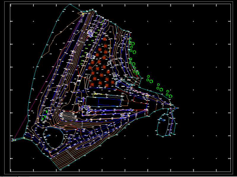

Yes this is the topo map, but there should also be an aerial photo which I tried to scale to fit the real size of the topo map
It is after I include this photo (by doing 'Insert'->'Attach Image', scale and do the 'zoom fit' command that everything disappears, now you have resumed the topo map only
The aerial photo belongs to the 'Ortofoto' layer.
As for the files which can't be loaded, these are files that the topographer didn't include for some reason when I was sent the topo map, I think one of the files is .ctb file and a .pdf file but I reckon they are not necessary to displaying the topo map itself.
When I did an "Erase > All" Draftsight reported back the following.  3834 found, 2 egroup, 7 not in drawing and 4 on frozen layer.  When I executed the Erase command using the Window option around the topo plan Draftsight it had found 1562 [objects], 2 egroup.
I have yet to find the aerial photo.  It seems unusual to see a topo map have its units of measurement set to millimeters.  Don't you agree?

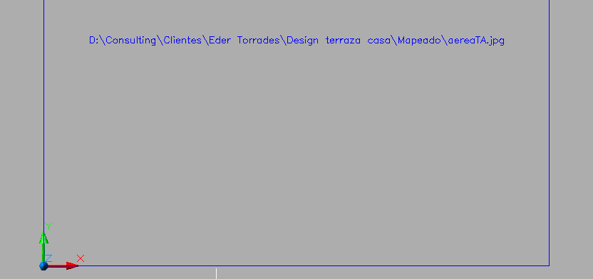

Not having DraftSight, but playing in AutoCAD, I found two images inserted at 0,0 and measuring 0.1194. This would be invisible when you do a zoom all. The UCS icon would hide the grips.

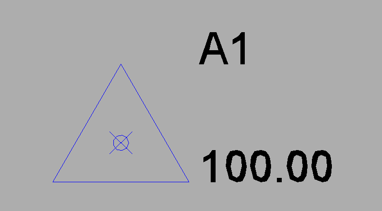

There were also 4 blocks BASEF near 0,0
What is a BASEF block?

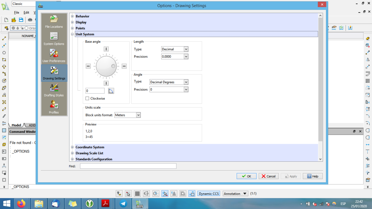

I do agree, but when I go to the Options section I see that the units of measurements are set in meters not in mm
May be there is more than one place where these need to be set appropriately?
