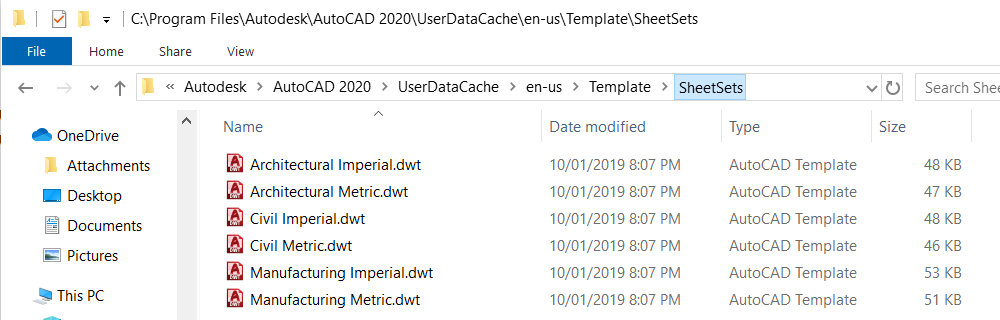

Open the original dwt that came with CIV3d.
