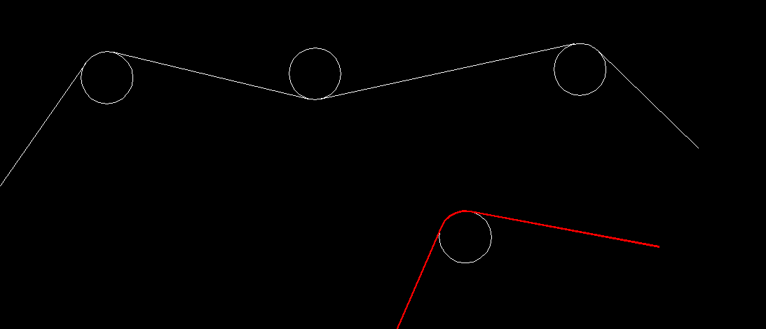

The purpose of the code is to draw a continous polyline tangent to each circle the user clicks. It is to show a path of paper through a machine around spinning idlers

You rock, Thank you for your help (and by help I mean complete re-write lol)! For the time being this works just as I needed. As I learn more I will modify this to have an undo option while in the loop in case user clicks the wrong circle or wants a different entry. This works for the majority of my possible paths for the polyline. I have found that when the line wraps a circle more then half it will not fillet passed that circle. There is a rare occasion where this will happen so I will also work on trying to fix that as I learn more about what I am doing.

4.It may be to big an issue to be fixable but the rare times where the "conveyer" wraps a pulley more then half of the circle it fails the remainder of the fillets

The angle greater than 180 your correct need to have a big think about that problem. I think can be solved looking at forward angle of the two lines.
