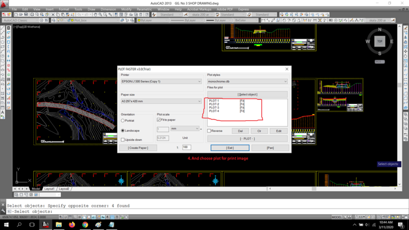

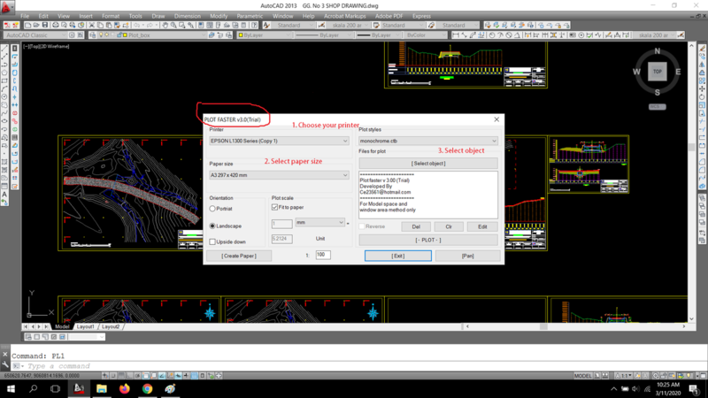

Help me to combine my autolisp :(
Oktaradian
12 minutes ago, Jonathan Handojo said:
If that really is a DCL dialog, that must be a damn ton... at least worth 700+ lines to get that kind of dialog. I can make it, but I don't have that kind of time, sorry.
I guess it's simple autolisp 😆
okay thanks for the help. You are very helpful
Pirating some ones hard work just because you don't want to pay is not something that I and others here support.
If you want something then you may have to pay for it,  I know Maratovich's plot routine is very good and cheap but has a price.
I have multiple plot routines and so do others and they are free.
Edited by BIGAL
7 hours ago, Oktaradian said:
I have autolisp in .VLX format, not .LSP
but this autolisp trial version. I tried to look for a similar autolisp, but did not find it on google.
I like this autolisp because it's fast to print images.
You can try to find out how it works, you can download the file here
Can you help me make autolisp similar like that?
Yes, I'll have to agree with @BIGAL on this one. I missed that sign there, good pickup bigal.
It's clearly copyrighted. And if I know better, that kind of dialog is lots of hard work... Like I said previously, at least 700+ lines, perhaps more. You'll just have to contact the email in the picture posted by bigal and ask him for the codes.
Can you share your multiple plot routines? And thanks for your advice. I'm still learning, please guide me
  • Dislike 1
