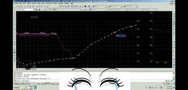

Oktaradian Posted January 16, 2020 Share Posted January 16, 2020 hi everyone, i have 2 different autolisp. I want to combine the two, but I'm too ordinary in terms of autolisp. can someone help me? Quote (defun c:test( / es ent str vtxlist c txtsize) (defun make_TEXT (content textstyle layer color coo degree textsize / txt_list) ;;entmake text (if (null textstyle) (setq textstyle "standard")) (setq txt_list (list (cons 0 "TEXT") (cons 1 content) (cons 7 textstyle) (cons 8 layer) (cons 62 color) (cons 10 coo) (cons 50 degree) (cons 40 textsize))) (entmake txt_list) (entlast) ) (if (setq es (car (entsel "\nSelect Polyline >> "))) (progn (setq ent (entget es)) (setq str "name");;; (setq vtxlist '()) (mapcar '(lambda (x) (if (eq (car x) 10) (setq vtxlist (append vtxlist (list (cdr x)))) ) ) ent);mapcar (setq c 1 txtsize 1) (foreach vtx vtxlist (make_text (strcat str (itoa c)) nil (getvar "clayer") 10 vtx 0 txtsize) (setq c (1+ c)) ) ) (alert "CANCELED") ) (princ) ) Quote (defun c:dcd (/ lstSS txtstr p1 p2 listname txt txt1 ss) (vl-load-com) (defun acet-ss-to-list (ss / n e l) (setq n (sslength ss)) (while (setq e (ssname ss (setq n (1- n)))) (setq l (cons e l)) ) ) ;Gan gia tri goc (if (not k0) (setq k0 1));;gan gia tri goc (setq k (getreal (strcat "\n Import Ratio of This drawing:1/" (rtos k0 2 0) "")));Nhap ty le ban ve (if (not k) (setq k k0) (setq k0 k)) (defun dowith(lstSS / lstSS en str) (cond ((setq en (car (vl-remove-if-not '(lambda(x)(wcmatch (cdadr (entget x))"*TEXT")) lstSS)))(setq str (acet-dxf 1 (entget en)) en (vlax-ename->vla-object en))) ((setq en (car (vl-remove-if-not '(lambda(x)(and (wcmatch (cdadr (entget x))"INSERT")(= (acet-dxf 66 (entget x)) 1))) lstSS))) (setq str (vla-get-textstring (setq en(car (vlax-invoke (vlax-ename->vla-object en) 'GetAttributes))))) ) ) (cons en str) ) (grtext -1 "Edit By Nguy\U+1EC5n Ng\U+1ECDc S\U+01A1n") (setq lstSS (acet-ss-to-list (setq ss (ssget))) obj (car (setq en (dowith lstSS))) str (cdr en) p1 (getpoint "\nOrigin Point:") eL (entlast) oDz (getvar "Dimzin") ) (setvar "DIMZIN" 0) (while (setq p2 (getpoint p1 "\nNext Point:")) (command "copy" ss "" p1 p2) (while (setq EL (entnext EL)) (setq Listname (cons EL Listname))) (setq Txt1 (car (dowith listName)) eL (entlast) ) (Ktra) (setvar "cecolor" "bylayer") (vla-put-textstring txt1 (strcat (cond ((> (setq num (+ (atof str) (/ (- (cadr p2)(cadr p1)) k))) 0) "") ((= num 0) "%%p") (T "") ) (rtos num 2 3));So chu so dau dau ; ) ) (setvar "DIMZIN" oDZ) ) ;Tim va tao moi Layer (defun ktra () (if (not (tblsearch "layer" "Caodo")) (command "-LAYER" "m" "Caodo" "c" 1 "Caodo" "" ) (setvar "clayer" "Caodo" ) ) ) I want the autolisp function like this: 1. pick point datum 2. select polyline 3. and text elevations appears at each vertex point Quote Link to comment Share on other sites More sharing options...
BIGAL Posted January 16, 2020 Share Posted January 16, 2020 Can you redo gif can not see what is happening to small. I have something similar. Quote Link to comment Share on other sites More sharing options...

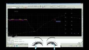

Oktaradian Posted January 17, 2020 Author Share Posted January 17, 2020 like this Quote Link to comment Share on other sites More sharing options...

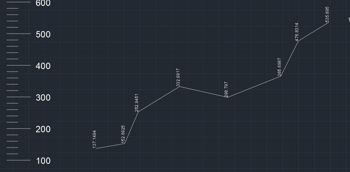

Jonathan Handojo Posted March 8, 2020 Share Posted March 8, 2020 (edited) (defun c:test ( / datum es hgts txt_color txt_height txt_layer txt_rotation txt_style vtxlist DegToRad) ;;; -------------------- SET TEXT PROPERTIES BELOW -------------------- ;;; (setq txt_height 10 txt_style "standard" txt_layer "New Layer" ; or nil to use current layer txt_rotation 90 ; in degrees txt_color acWhite ; or nil to use default color ) ;;; -------------------- SET TEXT PROPERTIES ABOVE -------------------- ;;; (defun DegToRad (x) (* (/ pi 180) x)) (while (progn (setq es (entsel "\nSelect Polyline >> ")) (cond ((not es) (princ "\nNothing selected")) ((wcmatch (cdr (assoc 0 (entget (car es)))) "~*POLYLINE") (princ "\nObject is not a polyline")) ) ) ) (setq datum (progn (initget 1) (getpoint "\nSpecify point for datum: ")) elev (progn (initget 1) (getreal "\nSpecify elevation at specified datum: ")) vtxlist (vl-remove-if-not '(lambda (x) (eq (car x) 10)) (entget (car es))) hgts (mapcar '(lambda (x) (+ elev (- (caddr x) (cadr datum)))) vtxlist) ) (mapcar '(lambda (x y) (entmake (vl-remove nil (list '(0 . "TEXT") (cons 7 (if (null (tblsearch "STYLE" txt_style)) "standard" txt_style)) (if txt_layer (cons 8 txt_layer)) (cons 10 (cdr x)) (cons 1 (rtos y)) (cons 50 (DegToRad txt_rotation)) (cons 40 txt_height) (if txt_color (cons 62 txt_color)) ) ) ) ) vtxlist hgts ) (princ) ) Edited March 9, 2020 by Jonathan Handojo Quote Link to comment Share on other sites More sharing options...

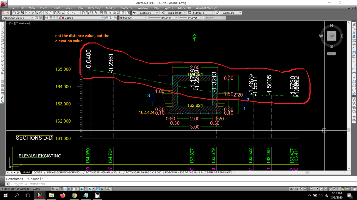

Oktaradian Posted March 9, 2020 Author Share Posted March 9, 2020 thanks. I've tried it. but not the distance value that I want. I tried to find the elevation value. Can you help me? Quote Link to comment Share on other sites More sharing options...
Jonathan Handojo Posted March 9, 2020 Share Posted March 9, 2020 (edited) Oops, I initially thought the datum was set at 0, hence those values. I've amended the changes to the above code to allow you to input the elevation value at the specified point. Try the above code again. If you specify the datum point at the 161, 163 or any mark and input that same value as the elevation height, you should get what you're after. Edited March 9, 2020 by Jonathan Handojo Quote Link to comment Share on other sites More sharing options...
Oktaradian Posted March 9, 2020 Author Share Posted March 9, 2020 sorry I don't really understand. I'm a beginner here. I already tried entering the datum value, but what appears is still the distance value not elevation Quote Link to comment Share on other sites More sharing options...

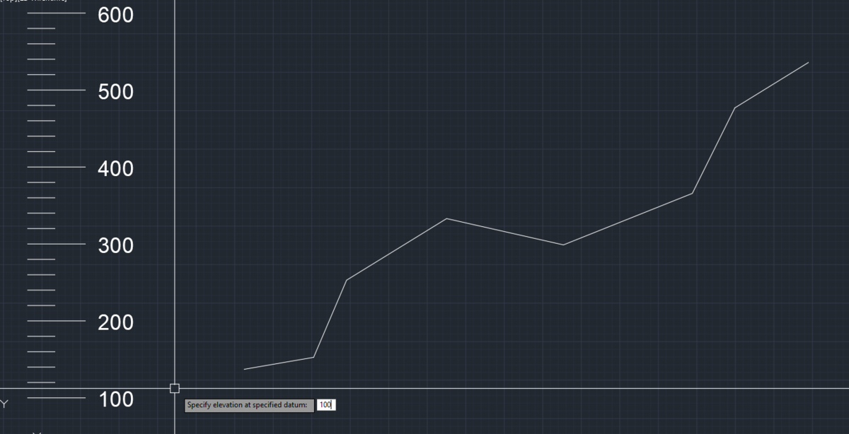

Jonathan Handojo Posted March 9, 2020 Share Posted March 9, 2020 (edited) The datum is there. The point at that datum is 100. There's the result. Perhaps the code wasn't updated: (defun c:test ( / datum es hgts txt_color txt_height txt_layer txt_rotation txt_style vtxlist DegToRad) ;;; -------------------- SET TEXT PROPERTIES BELOW -------------------- ;;; (setq txt_height 10 txt_style "standard" txt_layer "New Layer" ; or nil to use current layer txt_rotation 0 ; in degrees txt_color acWhite ; or nil to use default color ) ;;; -------------------- SET TEXT PROPERTIES ABOVE -------------------- ;;; (defun DegToRad (x) (* (/ pi 180) x)) (while (progn (setq es (entsel "\nSelect Polyline >> ")) (cond ((not es) (princ "\nNothing selected")) ((wcmatch (cdr (assoc 0 (entget (car es)))) "~*POLYLINE") (princ "\nObject is not a polyline")) ) ) ) (setq datum (progn (initget 1) (getpoint "\nSpecify point for datum: ")) elev (progn (initget 1) (getreal "\nSpecify elevation at specified datum: ")) vtxlist (vl-remove-if-not '(lambda (x) (eq (car x) 10)) (entget (car es))) hgts (mapcar '(lambda (x) (+ elev (- (caddr x) (cadr datum)))) vtxlist) ) (mapcar '(lambda (x y) (entmake (vl-remove nil (list '(0 . "TEXT") (cons 7 (if (null (tblsearch "STYLE" txt_style)) "standard" txt_style)) (if txt_layer (cons 8 txt_layer)) (cons 10 (cdr x)) (cons 1 (rtos y)) (cons 50 (DegToRad txt_rotation)) (cons 40 txt_height) (if txt_color (cons 62 txt_color)) ) ) ) ) vtxlist hgts ) (princ) ) Edited March 9, 2020 by Jonathan Handojo Quote Link to comment Share on other sites More sharing options...
hosneyalaa Posted March 9, 2020 Share Posted March 9, 2020 HI Jonathan Handojo Is it what you want Or something else Quote Link to comment Share on other sites More sharing options...
Jonathan Handojo Posted March 9, 2020 Share Posted March 9, 2020 (edited) Yea, exactly that. I updated the code at the previous post, but I guess it mustn't have been updated considering that your post above shows the earlier code before it was updated. I simply modified the below snippet: (setq datum (progn (initget 1) (getpoint "\nSpecify point for datum: ")) elev (progn (initget 1) (getreal "\nSpecify elevation at specified datum: ")) vtxlist (vl-remove-if-not '(lambda (x) (eq (car x) 10)) (entget (car es))) hgts (mapcar '(lambda (x) (+ elev (- (caddr x) (cadr datum)))) vtxlist) ) Simply using (initget 1) to make sure that the user does really input a number and doesn't press enter in order to have getreal return nil. And of course prompting the user for the elevation height for calculation Edited March 9, 2020 by Jonathan Handojo 1 Quote Link to comment Share on other sites More sharing options...
