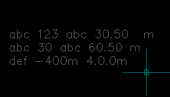

The lisp below is lee macs Parsing numerical values from a text.
I am wondering how to use this to change the colour within the selected Mtext only for real numbers that accompany "m", for example: 112.35m etc... <number> <dot> <number><m>
sometimes there is one space between the real number and "m", so if I could first remove the space for every real number within the text for each, then change the colour for each.
I gave it try and I seem not to be successful with this task.
Thanks

This form of problem is typically easier to solve using Regular Expressions, for example:

Note that the above does not account for pre-existing formatting within the MText.
@Lee Mac
How can I adjust this line to account for any dots, paran or other characters before and after the numbers Lee?
Example I have 12.75m .        or 215.56 m (blah)
also could you let me know how to correct the letter <m> so it will correct for example: 34.50 m   to   34.50m  (no space between <m>) please?
Also maybe due to formatting the lisp above works sometimes - I have another lisp to remove characters and change colour on certain words, so the colours are overridden and not by layer - Does this pose an issue, the reason why my output is random?
(vlax-put-property rgx 'pattern "( |^)(-?\\d+(?:\\.\\d+)?\\s*m)( |$)")
Thanks

Try the following instead:

                (vlax-put-property rgx 'pattern "( |^)(-?\\d+(?:\\.\\d+)?)\\s*(m)(\\s|\\W|$)")
                (setq new (strcat "$1{\\C" (itoa col) ";$2$3}$4"))

Hey Lee,
I have no words to describe how much i appreciate your work - simply wonderful!
Can I ask where I could possible obtain 'patten syntax or formula for future use. It is VERY obvious that you know all about autolisp but if I want to twick the property, would there be a website I could use?
THANK YOU VERY MUCH!
