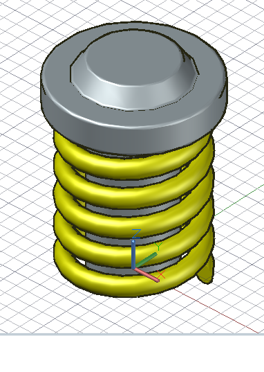

Which lines are you talking about? Which Visual Style are you using? You might adjust it in "Manage Visual Styles". I don't see the thin lines when I duplicated what you seem to have.

When I say the thin lines, i mean the ones around the top for example. "Isolines" they call it. If i turn them off I get an inconsistency of where contourlines are placed on the gray part. Because the lines stop half-way down:
There is still a thin line visible (seam?) on the inner center, but nothing on the edge.
Custom visual style, I'm trying to get a look that is similar to Sketchy but with materials and textures enabled.

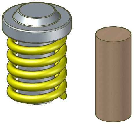

If you could post your model it would be easier to see which changes work.
I always found these sort of custom looks easier to do in something like Photoshop/GIMP and/or Illustrator/Inkscape after everything is complete with the model.

After more tinkering, it got slightly better:

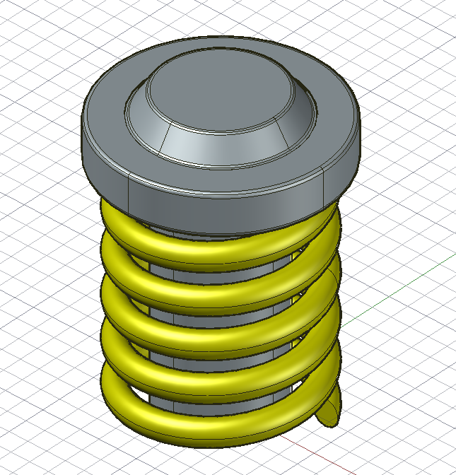

But this gives another issue:
That white line is not supposed to be there
Some of those issues seem to be graphics card related. Looks like you are on the right track.
On Visual Style -> set Crease angle = 178
On AutoCAD system variable - > facetres -> set smoothness factor to 10.0
Select objects and set -> Lightweight 1.0 mm or higher (I think this is what you look for)
Here what the objects look:
