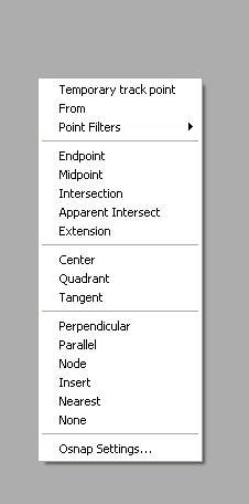

wannabe Posted January 30, 2009 Posted January 30, 2009 Shift and right mouse click is the quickest way for snaps, easily. Quote
eldon Posted January 31, 2009 Posted January 31, 2009 wannabe said: Shift and right mouse click is the quickest way for snaps, easily. The only trouble with that method is that you have to move the mouse pointer away from your scene of action. It is actually quicker to press one of the F-keys whilst the cursor stays still. Quote
Jaelin Posted January 31, 2009 Posted January 31, 2009 I would agree. I used to do the shift+right click method and the F keys are quicker/easier in my opinion. Quote
Cad64 Posted January 31, 2009 Posted January 31, 2009 Tiger said: I don't see how you can accuse that of being the culprit of everything - I'd lay the blame on shoddy autocad operators. I agree. Don't blame the Osnaps. They are just doing their job. Bad drawings are a result of poor CAD drafting skills or lazy operators. The only Osnaps I keep running, full time, are Endpoint, Midpoint, Intersection and Center. If I need any of the others, I just Shift+Right Click. Quote
wannabe Posted February 1, 2009 Posted February 1, 2009 eldon said: The only trouble with that method is that you have to move the mouse pointer away from your scene of action. It is actually quicker to press one of the F-keys whilst the cursor stays still. I never have to move my cursor and can't see why anyone should. Perhaps you could explain? Quote
dbroada Posted February 1, 2009 Posted February 1, 2009 Cad64 said: I agree. Don't blame the Osnaps. They are just doing their job. Bad drawings are a result of poor CAD drafting skills or lazy operators. The only Osnaps I keep running, full time, are Endpoint, Midpoint, Intersection and Center. If I need any of the others, I just Shift+Right Click. that's 2 more than me - I don't have mid or end point running normally. I don't like having endpoint AND intersection as we have so many bad drawings that almost have intersections but don't. I prefer to extend the line to create a real intersection than snap to what looks like one but isn't. Quote I never have to move my cursor and can't see why anyone should. Perhaps you could explain?I think he means that if you hover near the point and shift right click the dialogue box pops UP so you have to move your cursor up the list then back to the point. I shift right click too. Quote
eldon Posted February 2, 2009 Posted February 2, 2009 wannabe said: I never have to move my cursor and can't see why anyone should. Perhaps you could explain? OK. When you have got the Osnap dialogue box up on the screen, how do you pick your choice? You HAVE to move the cursor for the pick. Quote

rkent Posted February 3, 2009 Posted February 3, 2009 eldon said: OK. When you have got the Osnap dialogue box up on the screen, how do you pick your choice? You HAVE to move the cursor for the pick. When I shift+right click and the Osnap menu us up, a letter is underlined for each choice, just type that letter, P for Perpendicular, no need to move the mouse. I still prefer the Function Keys method. I keep them all off and use the F keys unless I know I need a lot of endpoints in a row, then I set that one to running. Quote
