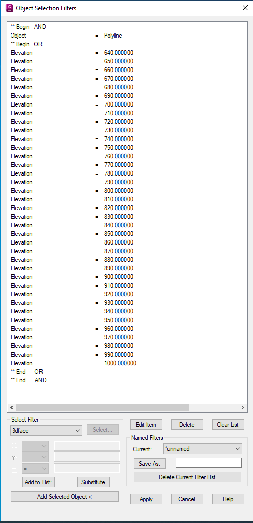

dylanphillips Posted June 19, 2023 Share Posted June 19, 2023 I know that this is an old thread, but how would I go about doing this but it automatically selecting all elevations from +10 to +2000? I am really struggling with the "amending to previous selection" I think. If you run this one after another it wont add to the previous selection. Thanks in advance! I am new to trying to accomplish writing my own code Quote Link to comment Share on other sites More sharing options...
Lee Mac Posted June 19, 2023 Share Posted June 19, 2023 4 hours ago, dylanphillips said: I know that this is an old thread, but how would I go about doing this but it automatically selecting all elevations from +10 to +2000? I am really struggling with the "amending to previous selection" I think. If you run this one after another it wont add to the previous selection. Thanks in advance! I am new to trying to accomplish writing my own code Consider the following code - (defun c:pk ( / zma zmi ) (if (and (setq zmi (getreal "\nSpecify elevation lower bound (inclusive): ")) (setq zma (getreal "\nSpecify elevation upper bound (inclusive): ")) ) (progn (if (< zma zmi) (mapcar 'set '(zmi zma) (list zma zmi))) (sssetfirst nil (ssget "_X" (list '(000 . "LWPOLYLINE") '(-04 . ">=") (cons 038 (- zmi 1e-3)) '(-04 . "<=") (cons 038 (+ zma 1e-3)) ) ) ) ) ) (princ) ) 2 Quote Link to comment Share on other sites More sharing options...
dylanphillips Posted June 20, 2023 Share Posted June 20, 2023 15 hours ago, Lee Mac said: Consider the following code - (defun c:pk ( / zma zmi ) (if (and (setq zmi (getreal "\nSpecify elevation lower bound (inclusive): ")) (setq zma (getreal "\nSpecify elevation upper bound (inclusive): ")) ) (progn (if (< zma zmi) (mapcar 'set '(zmi zma) (list zma zmi))) (sssetfirst nil (ssget "_X" (list '(000 . "LWPOLYLINE") '(-04 . ">=") (cons 038 (- zmi 1e-3)) '(-04 . "<=") (cons 038 (+ zma 1e-3)) ) ) ) ) ) (princ) ) Thank you for such a quick response Lee Mac. I'm sorry I left out the most important part of this, I am only wanting to select the 10's. so I would want to select 10, 20, 30, etc. That is why I am struggling with the amending. I have been trying to do it with a while loop, but I am not sure where to put the while loop to keep the current ones selected. If that makes any sense. Here is what I have, although I know it has issues (defun c:ELEVSEL ( / z ) ;; Define function, declare local variables (setq z 10) (while (<= z 2000) ; Ending z (sssetfirst ;; Highlight the following selection set nil ;; This argument was never properly implemented (ssget ;; Attempt to obtain a selection set "_X" ;; Search entire database (list ;; Construct the following filter list '(0 . "LWPOLYLINE") ;; Entity type '(-4 . ">=") ;; For some tolerance (cons 38 (- z 1e-3)) ;; Elevation lower bound '(-4 . "<=") ;; For some tolerance (cons 38 (+ z 1e-3)) ;; Elevation upper bound ) ;; end list ) ;; end ssget ) ;; end sssetfirst (setq z (+ z 10)) ; Increment z by 10 ) ;; end while ;; Else the user dismissed the prompt: (princ "\nUser cancelled.") (princ) ;; Return a null symbol to the command-line ) ;; end defun Again, thank you so much for all of your help!!!! Quote Link to comment Share on other sites More sharing options...
Tharwat Posted June 20, 2023 Share Posted June 20, 2023 Something like this ? (defun c:Test (/ int sel ent add get ) ;;----------------------------------------------------;; ;; Author : Tharwat Al Choufi ;; ;; website: https://autolispprograms.wordpress.com ;; ;;----------------------------------------------------;; (and (setq int -1 add (ssadd) sel (ssget "_X" (list (cons 410 (getvar CTAB)) '(0 . "LWPOLYLINE") '(-04 . ">=") (cons 38 10))) ) (while (setq int (1+ int) ent (ssname sel int)) (and (setq get (entget ent)) (zerop (rem (cdr (assoc 38 get)) 10)) (ssadd ent add) ) ) ) (sssetfirst nil add) (princ) ) Quote Link to comment Share on other sites More sharing options...
dylanphillips Posted June 20, 2023 Share Posted June 20, 2023 (edited) 2 hours ago, Tharwat said: Something like this ? (defun c:Test (/ int sel ent add get ) ;;----------------------------------------------------;; ;; Author : Tharwat Al Choufi ;; ;; website: https://autolispprograms.wordpress.com ;; ;;----------------------------------------------------;; (and (setq int -1 add (ssadd) sel (ssget "_X" (list (cons 410 (getvar CTAB)) '(0 . "LWPOLYLINE") '(-04 . ">=") (cons 38 10))) ) (while (setq int (1+ int) ent (ssname sel int)) (and (setq get (entget ent)) (zerop (rem (cdr (assoc 38 get)) 10)) (ssadd ent add) ) ) ) (sssetfirst nil add) (princ) ) Thanks for the quick response again! I am honestly not sure exactly what you have done here, it is way over my head honestly...but I am getting this error whenever I try to run it: ; error: bad argument type: (or stringp symbolp): nil Essentially I am wanting to select all polylines with elevations ending in zeros (or every 10) in the range of 10 to 2000 to put them on a different layer. So it would select 10, 20,30,40,50,60,70,80,90,100,110,etc all the way to 2000. In the past I have done this with a filter, which I have posted below, but I just want to do this with a lisp. I shortened my filter so that you can see everything, but I had it going from 10 -> 2000. Thanks in advance again! Edited June 20, 2023 by dylanphillips Quote Link to comment Share on other sites More sharing options...
Tharwat Posted June 20, 2023 Share Posted June 20, 2023 (edited) Oops , the elevation value has to be decimal and the I forgot to quote the system variable, so try this instead and let me know. (defun c:Test (/ int sel ent add ) ;;----------------------------------------------------;; ;; Author : Tharwat Al Choufi ;; ;; website: https://autolispprograms.wordpress.com ;; ;;----------------------------------------------------;; (and (setq int -1 add (ssadd) sel (ssget "_X" (list (cons 410 (getvar 'CTAB)) '(0 . "LWPOLYLINE") '(-04 . ">=") '(38 . 10.0))) ) (while (setq int (1+ int) ent (ssname sel int)) (and (zerop (rem (cdr (assoc 38 (entget ent))) 10.0)) (ssadd ent add) ) ) ) (sssetfirst nil add) (princ) ) Edited June 20, 2023 by Tharwat Quote Link to comment Share on other sites More sharing options...
dylanphillips Posted June 20, 2023 Share Posted June 20, 2023 8 minutes ago, Tharwat said: Oops , the elevation value has to be decimal and the I forgot to quote the system variable, so try this instead and let me know. (defun c:Test (/ int sel ent add ) ;;----------------------------------------------------;; ;; Author : Tharwat Al Choufi ;; ;; website: https://autolispprograms.wordpress.com ;; ;;----------------------------------------------------;; (and (setq int -1 add (ssadd) sel (ssget "_X" (list (cons 410 (getvar 'CTAB)) '(0 . "LWPOLYLINE") '(-04 . ">=") '(38 . 10.0))) ) (while (setq int (1+ int) ent (ssname sel int)) (and (zerop (rem (cdr (assoc 38 (entget ent))) 10.0)) (ssadd ent add) ) ) ) (sssetfirst nil add) (princ) ) YES!! Thank you so so so much!!! I have been working on this for months! Quote Link to comment Share on other sites More sharing options...

Steven P Posted June 21, 2023 Share Posted June 21, 2023 (edited) Nice succinct code above, but just because I wondered if it could be done.... This filters the lines during the selection set selection rather than afterwards - in a round about way. Was curious if it could be done similar to above (the key being create the selection set command as a text string, it can be generated with formulas, loops, calculations and so on, remember numbers need to be strings), then an "(eval (read" line. Could be useful in other places too where you want several unique selections in a selection set, might be quite versatile - if long winded Like the DyllanPhillips example code, no selection set variable generated but this can easily be added (defun c:test ( / Z MyCommand) (setq Z 10) ; lower limit (setq UL 2000) ; upper limit (setq MyCommand ;; create ssget command as text string. Allows for loops, while, foreach.... "(ssget \"_X\" (list '(0 . \"LWPOLYLINE\") '(-4 . \"<OR\") " ) ; end strcat, end setq (while (<= Z UL) ; loop - could be a foreach (if list of unique elevations, other calculations (setq MyCommand (strcat MyCommand "'(-4 . \"<AND\") '( -4 . \">=\") '( 38 . " (rtos (- Z 1e-3)) ") " ;; Elevation lower bound "'( -4 . \"<=\") '( 38 . " (rtos (+ Z 1e-3)) ") " ;; Elevation upper bound "'(-4 . \"AND>\") " )) ; end strcat, end setq (setq Z (+ Z 10)) ) ; end while (setq MyCommand (strcat MyCommand "'(-4 . \"OR>\") ))" )) ; end strcat, end setq (sssetfirst nil (eval (read MyCommand)) ) (princ) ) Edited June 21, 2023 by Steven P Quote Link to comment Share on other sites More sharing options...
