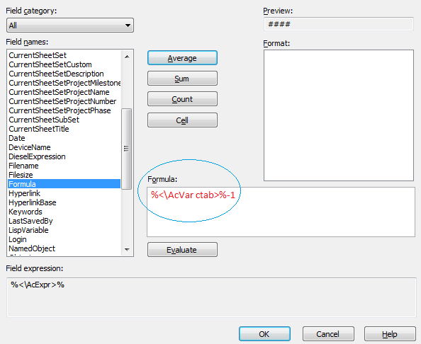

suggestion: in Layout (paper space) make sure layout name is numerical.
1. Insert your arrow block eg: layout 01
2. make 2 field objects
command: FIELD
in Field category -> All -> Formula
copy this expression
Quote
%<\AcVar ctab>%-1
%<\AcVar ctab>%+1
to formula space
3. evaluate and insert 'field-text' in layout
4. manually align 'field text' with the arrow block
5. Select aligned arrows blocks & texts, Copy <Crtl^C>  then paste to others layout eg: 02, 03, 04 etc..
   the 'sheet No: ###' it will be updated automatically according to layout name

sir i tried this method but not able to use can u create a video for me
well, i think field-attributed block is better than align MTEXT as mentioned in my previous post
$0.02 making a drawing faster than making a video !!
download this example
sheet no.dwg
 In layout 01 you will see this 2 blocks
Sheet No: 00            Sheet No: 02
simply copy both blocks from layout 01 & paste it to other layout 02, 03, etc..
