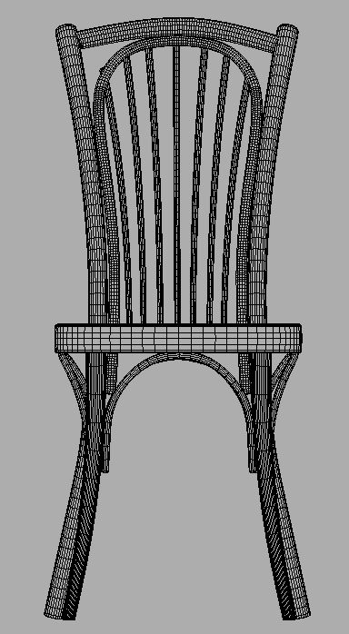

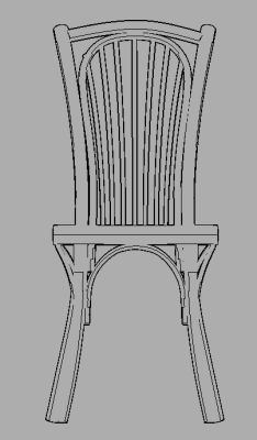

So far I'm using FLATTEN command and it works, it flattens it but I don't get the outline of the 3d object (like when you choose 'hidden' in visual style) but I get grid lines in between the outer lines as well. Is there some way to only get outer lines with FLATTEN?
EDIT: I solved it. I managed to convert the object to poly and FLATSHOT now works, but I still get the same looking object like I did with FLATTEN. So again, is there some way to get flatten 2D that is only outlines like when you choose 'hidden' in visual style?

I guess you didn't see the second part of the post where I explained that I solved that problem, and now I was just wondering if I could get 2D with flatshot to look like this
Instead of like what I get
Quote
No, actually I did see your whole post, which is why I asked to see what you were working on. You said you were able to convert it to "poly", but I'm not sure what you mean by that? That model appears to be a mesh object, not a solid model. Was it created in another program and then imported into Autocad? I guess you don't want to provide your file for testing, so this is as far as I can go with providing assistance. I tried importing one of my .3ds files, but I get the same result when running Flatshot.
