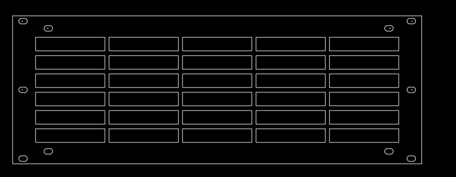

BIGAL Posted January 11, 2020 Posted January 11, 2020 I opened your sample 1st thing is exploded. did some basic sizing to work out grills. Is this what you want ? Grids can be different sizes. Tell us the sizes you want and can do instructions. Quote

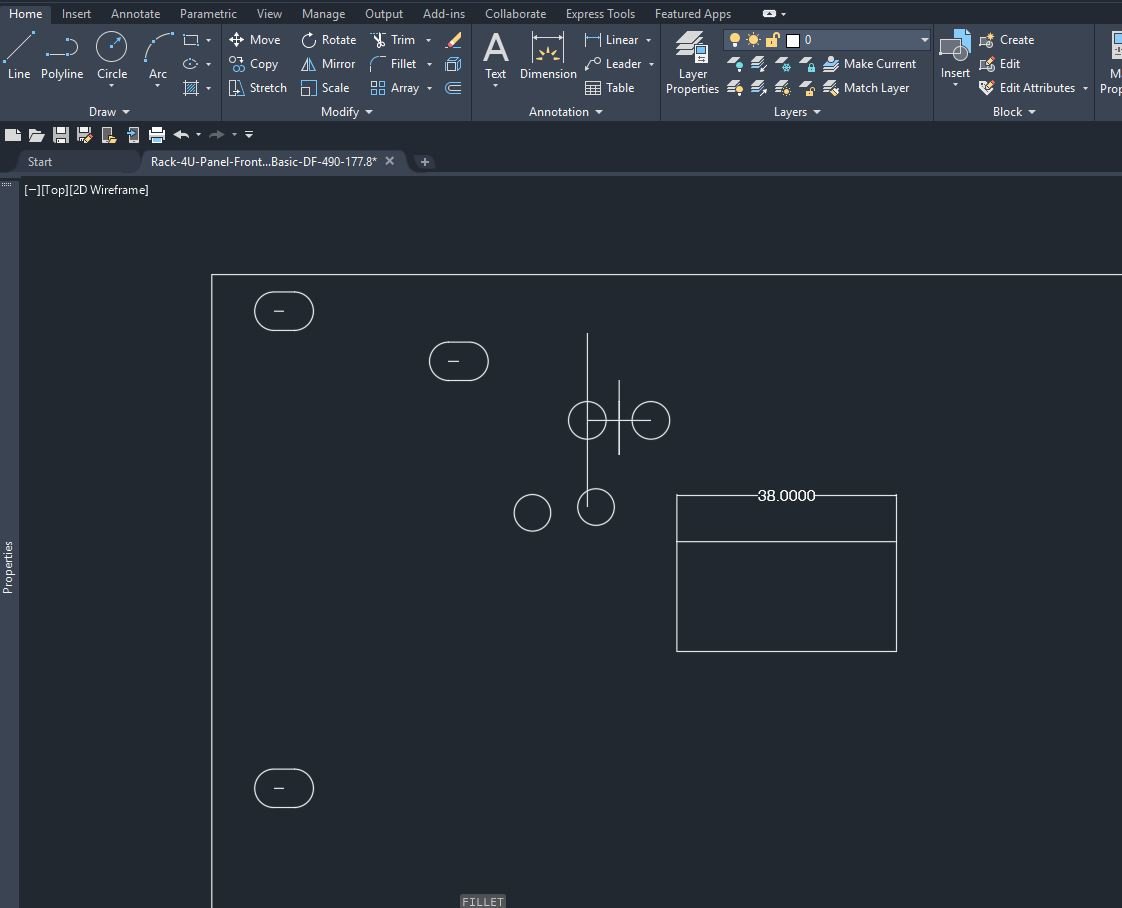

foxint Posted January 17, 2020 Author Posted January 17, 2020 Hi Al Thank you. I am having a lot of trouble with the cursor; it keeps wobbling around. Also, cannot use dimension (to show the lengths) as the cursor will not link to the shapes. I am trying to get the circle centres to be 3.5mm, but with the top line I am always overshooting the tangent of the circle. (Circle radius is 3.25mm) Any suggestions?? Quote

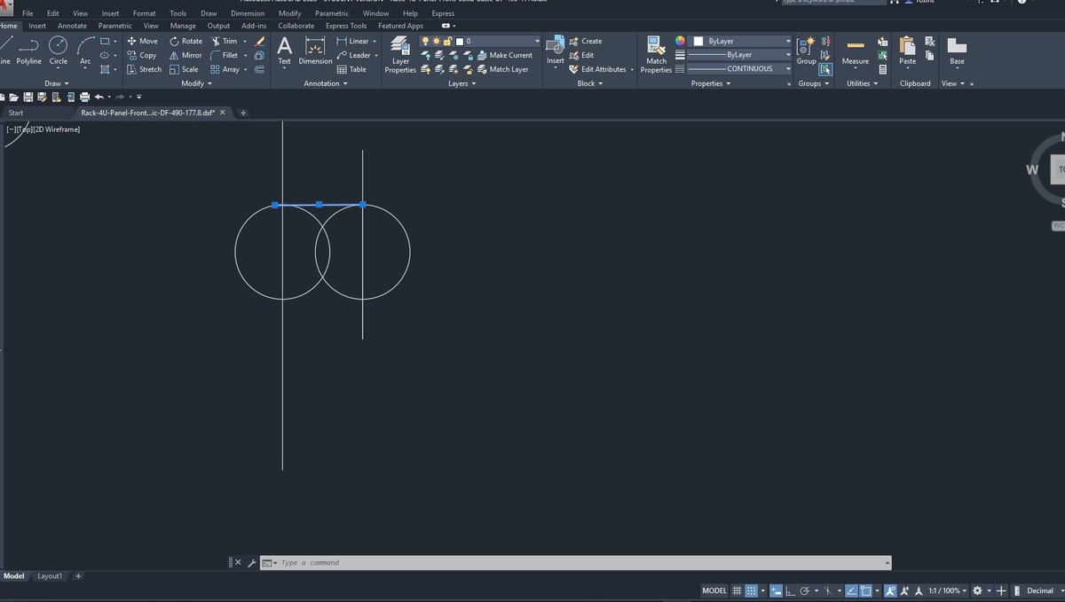

BIGAL Posted January 17, 2020 Posted January 17, 2020 1st thing type "Snap off", you can preset snap spacings it can be a pain if turned on makes screen jerky. Ok "Osnap" is your friend choose to clear all, then select End ,Intersection ,mid, centre. Remember key F3 turns off and on. If you hold shift and right click mouse the osnaps should appear. This can be handy to override the snap if it keeps grabbing wrong one. In above problem zoom in a bit more, you get used to rolling the mouse scroll button, if this does not do zooming let us know. Same hold down scroll button and that's a pan. Quote
foxint Posted January 18, 2020 Author Posted January 18, 2020 (edited) Hi Al Thanks. I am using F3 and the cursor still jumps around. I am trying to make sure the circle centres are 3.5mm, but all I seem to do is move the circle. I am not sure what I am doing. When I am trying to use Dimension, it manages to mark RHS circle centre with a little L, but jumps on both sides of the middle of the LHS circle, ??? I also tried the align tool to align the 2 circles. I watched 5 videos and I could not complete the command. All the videos show the parts moving all manner of ways. All I want is to align the 2 circles on the same plane. But the align tool just moves them together. Or is there another tool?? Any suggestions? Edited January 18, 2020 by foxint Quote

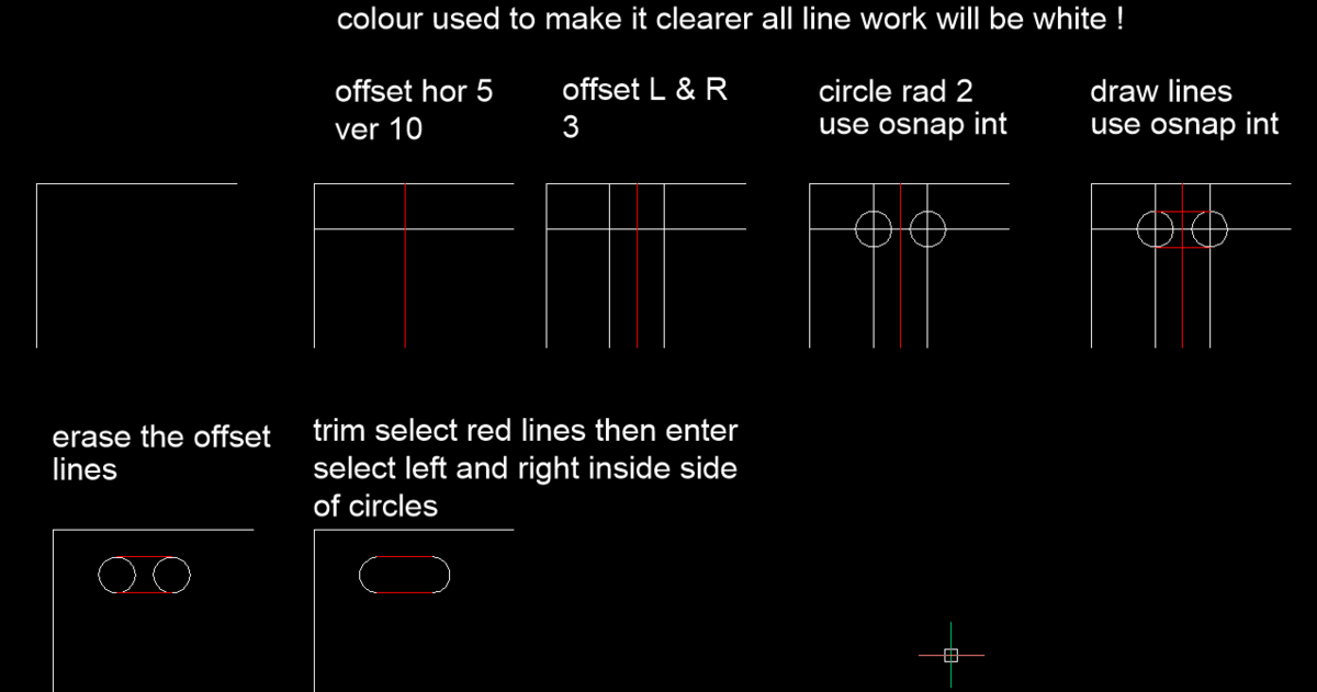

BIGAL Posted January 18, 2020 Posted January 18, 2020 (edited) No idea why you are using align !. Look at my image add circles using intersection snap, then draw 2 circles, add lines again use intersection snap. Then I used trim to remove the inside of the circles. I will make some enquiries about a webinar for you. That means you can see my PC and I can see yours and see what your doing wrong and we can talk at same time. Edited January 18, 2020 by BIGAL Quote

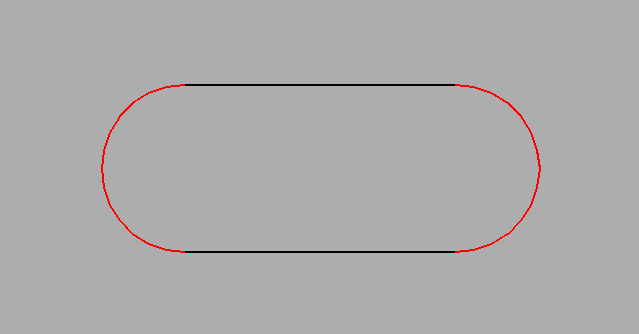

eldon Posted January 18, 2020 Posted January 18, 2020 I am confused as to what your dimensions should be, but I would like to offer another way to draw your vent hole without using the circle command. A few bits of information:- when you Offset a line, you get a parallel line. When you Fillet two parallel lines, you get a semicircle drawn to join the two lines. So, draw a line equal to the distance between the centres of the two circles. Offset this line by the diameter of the circles, then Fillet each end of the lines. Result one vent hole. Quote
