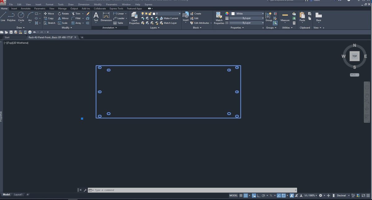

steven-g Posted January 5, 2020 Share Posted January 5, 2020 First thing when you open the drawing, if you can't see the object you need to use the zoom command with the 'extents' option. The easiest way to do taht is just press 'z' on your keyboard and then press the enter key, next press 'e' and again press enter. Before you go any further, take a screenshot of your Autocad window and post it here so we can see which tools and palettes you have turned on. Quote Link to comment Share on other sites More sharing options...
foxint Posted January 5, 2020 Author Share Posted January 5, 2020 Hi Steve-G Thank you...WOW that "e' sure filled up the screen..... I have stated from scratch. But I think the ovals are all wrong as I copied them from FreeCAD and I cannot get the centres so I can fix the space between them - they need to line up exactly with my Rack (465mm and 408mm) D Quote Link to comment Share on other sites More sharing options...

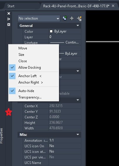

steven-g Posted January 5, 2020 Share Posted January 5, 2020 Turn on your properties palette, just type 'properties' followed by enter, and then looking at the attached image, right click on the bar along the edge that has the 'X' (close) on it somewhere in the middle (see the red star - that is in the image, not on your screen) and then tick the items shown. this will place the properties to the left of your screen and also make sure it collapses out of the way when you move away from it with your mouse, it opens up when you move over the bar again. Then click on any object in your drawing and open the properties you should see that it tells you at the top that the object is a block (in the image it now reads - No selection). Once you have the block selected you can explode it, again the quickest method is just type 'x' followed by the enter key. Quote Link to comment Share on other sites More sharing options...

steven-g Posted January 5, 2020 Share Posted January 5, 2020 When you have selected the object, you should see the information about that object in the properties, at the top it will say Block Reference, and as you look down it tells you information about that object such as it's name 'SKETCH036'. Different types of object show you different information. Quote Link to comment Share on other sites More sharing options...

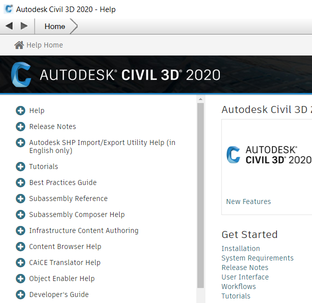

BIGAL Posted January 5, 2020 Share Posted January 5, 2020 (edited) Have a look at Kindle there are Autocad books and very cheap like $8. Autocad for dummies, I used to have some old Autocad original manuals but left them behind when I retired would have sent them to you. https://knowledge.autodesk.com/support/autocad/learn?sort=score not a bad starting point need to follow down pages clicking links to get deeper into explanations showing examples. When you press F1 does this come up and you have the option Tutorials. I have CIV3D should be same for Autocad. Edited January 5, 2020 by BIGAL Quote Link to comment Share on other sites More sharing options...

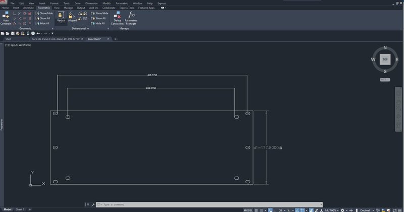

ReMark Posted January 8, 2020 Share Posted January 8, 2020 (edited) I opened the drawing that I posted for your use previously and measured the length and width of the panel. I found it to be 490mm x 177.8mm. So, using the numbers you provided (461mm x 408mm) we find that the panel is longer, in length, by 29mm and shorter, in width, by 230.2mm. Therefore we have two choices. We can either redraw the panel at the correct size or using the STRETCH command we can resize the panel to match our expectations. In my opinion it would far easier to just redraw the panel. There are multiple ways this can be accomplished. I will demonstrate one such way that does not require the user to do anything more than to pick the starting point for our rectangle. Command: RECTANGLE Specify first corner point or [Chamfer/Elevation/Fillet/Thickness/Width]: Choose an arbitrary point above the top left hand corner of the existing panel. Specify other corner point or [Area/Dimensions/Rotation]: Type "D" for Dimensions Specify length for rectangles <50.0000>: Type 461 Specify width for rectangles <10.0000>: Type 408 There you have it. Note that the rectangle is one complete entity although it has four sides. Why is that? Because it was drawn using a POLYLINE as opposed to a LINE. If we had used lines there would be four distinct entities. We can emulate this by exploding our polyline rectangle using the EXPLODE command if we wished to do so. Try it. If you want to return the rectangle back to its polyline configuration type "U" for UNDO on the command line. The result of the EXPLODE command will be undone. Edited January 8, 2020 by ReMark Quote Link to comment Share on other sites More sharing options...
ReMark Posted January 8, 2020 Share Posted January 8, 2020 Measuring the length and width of the panel can be accomplished using the MEASURE > DISTANCE command. But first we must make sure we have an adequate range of object snaps available to use. Right-click on OSNAPS in the tray at the bottom of your screen. We want to select the Object Snaps tab in the Drafting Settings window. Enable the following (at the bare minimum): ENDpoint, MIDpoint, CENter, QUADrant, and INTersection then close the window. We use OSNAPS (Object Snaps) for precision. Now back in our drawing invoke the MEASURE > DISTANCE command. You will be prompted to... Specify a first point: Select the bottom left hand corner of the rectangle. Specify a second point: Select the bottom right hand corner of the rectangle. The distance will be displayed on the command line below. Repeat the command by pressing the ENTER key and select the bottom right hand corner of the rectangle, as your first point, then the top right hand corner, as your second point. Once again look to the command line for the displayed distance. Quote Link to comment Share on other sites More sharing options...
ReMark Posted January 8, 2020 Share Posted January 8, 2020 Let's turn our attention now to the holes or slots as I shall refer to them. In the drawing I posted the slots are a single entity (polyline). They measure 10.15 in length and 6.65 in width. Now I have three questions for you: -Do you want to use slots or holes for your screws? -If you want to use a slot what length and width should it be? -If you want to use a circle what diameter should it to be? You can verify the horizontal distance between slots by using the method I demonstrated above. However, we measure from the MIDpoint of one slot to the MIDpoint of the opposite slot and because we have MIDpoint selected as one of our OSNAPS we can confirm we are picking the correct point because a triangle will appear instead of a square at the intersection of our crosshairs. If we were measuring between two holes a circle would appear instead. You can verify the vertical distance between slots on the same side in much the same manner. Quote Link to comment Share on other sites More sharing options...

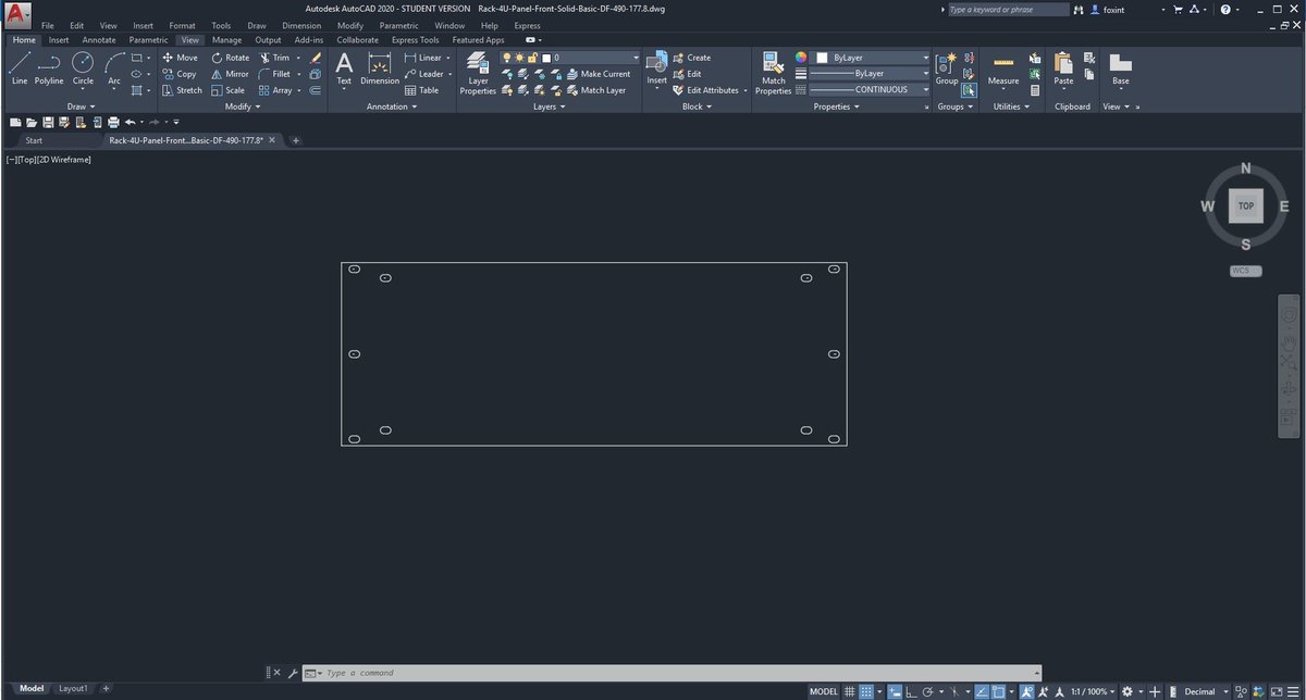

foxint Posted January 8, 2020 Author Share Posted January 8, 2020 Guys Thank you. Sorry I am getting very confused…. For some reason the dxf file is stuffed. I will have to leave this as it is too hard. My rack panel – essentially a flat rectangle that I will get laser cut. (I wish someone changed the rack to metric and standardised its development). Overall size – 490 x 177.8mm Slots #1 – for attaching to the rack mid-point to mid-point is 465mm Slots #2 – for attaching to the enclosure mid-pint to mid-point is 408mm Length/height of slot (so I have some play for inaccuracies) – I used a circle radius 3.325 with the distance between the centres of 3.5mm Vent holes (we have not gone down that rabbit hole) – (I am measuring from the physical) diameter about 3.0mm overall length 12.75 – but this can be changed . Just so we are on the same page. Quote Link to comment Share on other sites More sharing options...
ReMark Posted January 8, 2020 Share Posted January 8, 2020 (edited) Just what are you confused about? You don't need the .dxf file if you are going to draw the rack yourself. I've already provided you with the command for drawing the rack. As for the "slots" it appears from your post above they are nothing more than holes which can be created by using the CIRCLE command. You can draw the circles and position them on one side of the rack then use the MIRROR command to reproduce them on the other side. And you are right, the vent holes would indeed be another matter. You would need to the size of vent holes and how many rows and columns of vent holes would be required. Once you have drawn the first vent hole the remainder could be created using the ARRAY command. Yes, I make it sound so easy but it won't be as easy for you since you are new to AutoCAD so that is to be expected. Someone could offer to draw it for you but then what would be the point as you wouldn't learn a thing. That is why I gave you the link to MyCADsite in a previous post. Did you visit the website? Edited January 8, 2020 by ReMark Quote Link to comment Share on other sites More sharing options...
