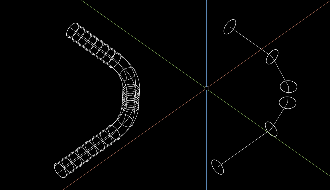

Jack_O'neill Posted March 24, 2020 Author Share Posted March 24, 2020 Howdy folks....I'm back. Anybody up for a challenge? Remember the code Roy_043 built for me in this thread? It works perfectly and I use it all the time. But now, I have a need for a lisp that does just the opposite. I have a customer sending me solid models, with no dimensions. What I need to do now is take that model, draw a lines from the end of the tube down the center to the tangent of the bend, then tangent to tangent for however many and then stop at the opposite end of the tube. Then I need to zero fillet all those line segments, and create the bend data table as it appears earlier in this thread. Is that a doable thing? I suppose it would be necessary to move the center of one end of the tube to 0,0,0 and orient at least the first bend to the ucs...that's no problem. I can do that. I'd be willing to trade some drafting as payment if needed. I have Autocad 2020 and am pretty good with mechanical drawing, not too bad on architectural stuff but don't know the first thing about civil. Would be happy to do an equitable amount of redline markups or whatever you needed. Thanks! Quote Link to comment Share on other sites More sharing options...

marko_ribar Posted March 25, 2020 Share Posted March 25, 2020 (edited) For such a 3DSOLID, I guess it would be very difficult if even possible. What I mean is that while working, avoid creating 3DSOLIDS TUBES that don't belong to SWEEPS - it seems that you lost important info ab path... Even with path, tubes are very difficult and IMHO, path can be only approximation especially if curve is spline like... I see that you are working with only tubes, so I can't be of much help, but if your cross section curve has a vertex (not circle), and you created SWEEP, you can try trick like this : Copy sweep on other place, then stretch vertex of shape to centroid - should be like grip at start of sweep... Then your isolines of 3DSOLID will follow path... Then only way I see is to manually SOLIDEDIT and copy edges of solid that are following path... Finally - also manually you join copied edges to single curve - path with JOIN command... Then you copybase path with 0,0,0... Do UNDO until original cross section shape... pasteclip to 0,0,0 and finally you copy path from vertex point of copy of 3DSOLID - SWEEP to original 3DSOLID... With TUBES it's different - you don't have that vertex on cross section shape - so my intention was - extract isolines - leave only cross sections (circles) - then you connect centers of circles - if it's spline like path that's a problem - you have to have many circles... Routine could be made for connecting regions centroids obtained from circles that are next to each other... Finally you join lines to 3DPOLY with JOIN and then also you can convert 3DPOLY to SPLINE if necessary... For extracting isolines from 3DSOLIDS or SURFACES, look into topic by Kean Walmsley - with the same problem at through-the-interface-typepad.com Edited March 25, 2020 by marko_ribar Quote Link to comment Share on other sites More sharing options...

Roy_043 Posted March 26, 2020 Share Posted March 26, 2020 If you explode the solid you get 2 regions (1 for each end cap) and several surfaces. Exploding these entities one by on gives you 1 or, for the surfaces, 2 circles. If the 2 circles derived from a surface have the same normal, we can probably (in this context at least) assume the surface was cylindrical and use their centers to draw a center line... Etc. It seems to me that creating Lisp code for this is doable. But creating the center lines manually should also be relatively easy: Osnap center, draw lines, fillet... Note 1: I am using BricsCAD. Note 2: I am not going to write the Lisp code. Quote Link to comment Share on other sites More sharing options...
Jack_O'neill Posted March 26, 2020 Author Share Posted March 26, 2020 10 hours ago, Roy_043 said: If you explode the solid you get 2 regions (1 for each end cap) and several surfaces. Exploding these entities one by on gives you 1 or, for the surfaces, 2 circles. If the 2 circles derived from a surface have the same normal, we can probably (in this context at least) assume the surface was cylindrical and use their centers to draw a center line... Etc. It seems to me that creating Lisp code for this is doable. But creating the center lines manually should also be relatively easy: Osnap center, draw lines, fillet... Note 1: I am using BricsCAD. Note 2: I am not going to write the Lisp code. As I said, I do it manually now. I simply switch the shading to wire frame. It shows a circle at the end of each straight, i draw a line from circle to circle at each straight, then zero fillet them to get the intersection points. No biggie, but if we win this package there will be hundreds of them to do. I appreciate everything everyone has offered on this. Note 1: I wasn't looking for a freebee, I asked if it was possible. Note 2: I offered to trade drafting work for any effort anyone put in. If someone don't want to do that...that's fine, all ya gotta do is say so. Or for that matter, say nothing. It's all good. See you guys later. Gotta get back to drawing stuff. Quote Link to comment Share on other sites More sharing options...

marko_ribar Posted March 27, 2020 Share Posted March 27, 2020 (edited) Here is how I reconstructed tube path... Segmentation per segment is 64 vertices... But unfortunately I can't post my used routines and beside that one is dll (extracting isolines)... Of course, you can convert 3dpoly to 3dspline if you want, that's not such a big deal... P.S. If you have 3DSPLINED TUBE, I can try my method on them as well... Regards... test-tubes.dwg Edited March 28, 2020 by marko_ribar Quote Link to comment Share on other sites More sharing options...
