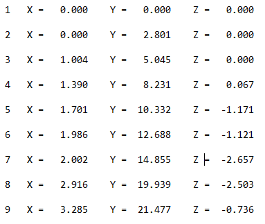

Sorry, I forget that not everybody spends their days blissfully drawing tubes...lol.  At any rate, what I get from the customer is not a drawing but a table with 3d coordinates similar to this:
These arrive in various forms. Sometimes a txt file, sometimes a word document, an excel file, a pdf....just about any means you can come up with.

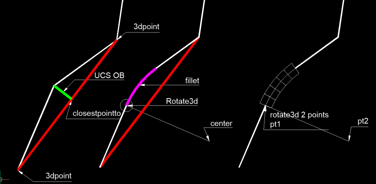

I don't play much with 3d stuff but would not using UCS  then I exploded the pline and added a true arc on a plane at each intersection. Then using extrude for each element and a union. The must do is to make sure the circle is perpendicular to the extrude path. There was a staircase scenario similar problem  posted here.

Ok,  I take a table of 3d coordinates like this:
These are absolute coordinates, not relative.

That's what I was getting at, you should be able to create the arc via ucs, and put a circle at correct location and rotate3d to start end. Just take the points and draw a line Pt1 pt3, then take pt2 and draw a line perp to the 1st line use this for UCS ob.
If I have time will have a go, I know did something similar once before.
Starting to play jack post as csv etc had to make.

Not sure and hard to check, when you fillet 2 3d lines the arc is created in the x y current UCS plane not a tilted plane, so it may be a spline actually, watch a car exhaust pipe being made only bends in 1 direction so tube must be rotated.
The other is similar that the circle must be added at a true 90 to the direction of the line or in the case of the arc a 3d plane.
More than happy to accept that I am wrong in my ideas. There are smarter 3d people than me out there.

Roy_043 yes your right if do 2 3d  lines with no fillet union will be a odd intersection.
But if you do it my way using ucs it will work correctly as you can make the two lines into a pline and use that as the path.This the way I think I would go with coding. Look at second image done with 1 path. I think it will still have to do each segment extrude individually including arcs then union them all.
